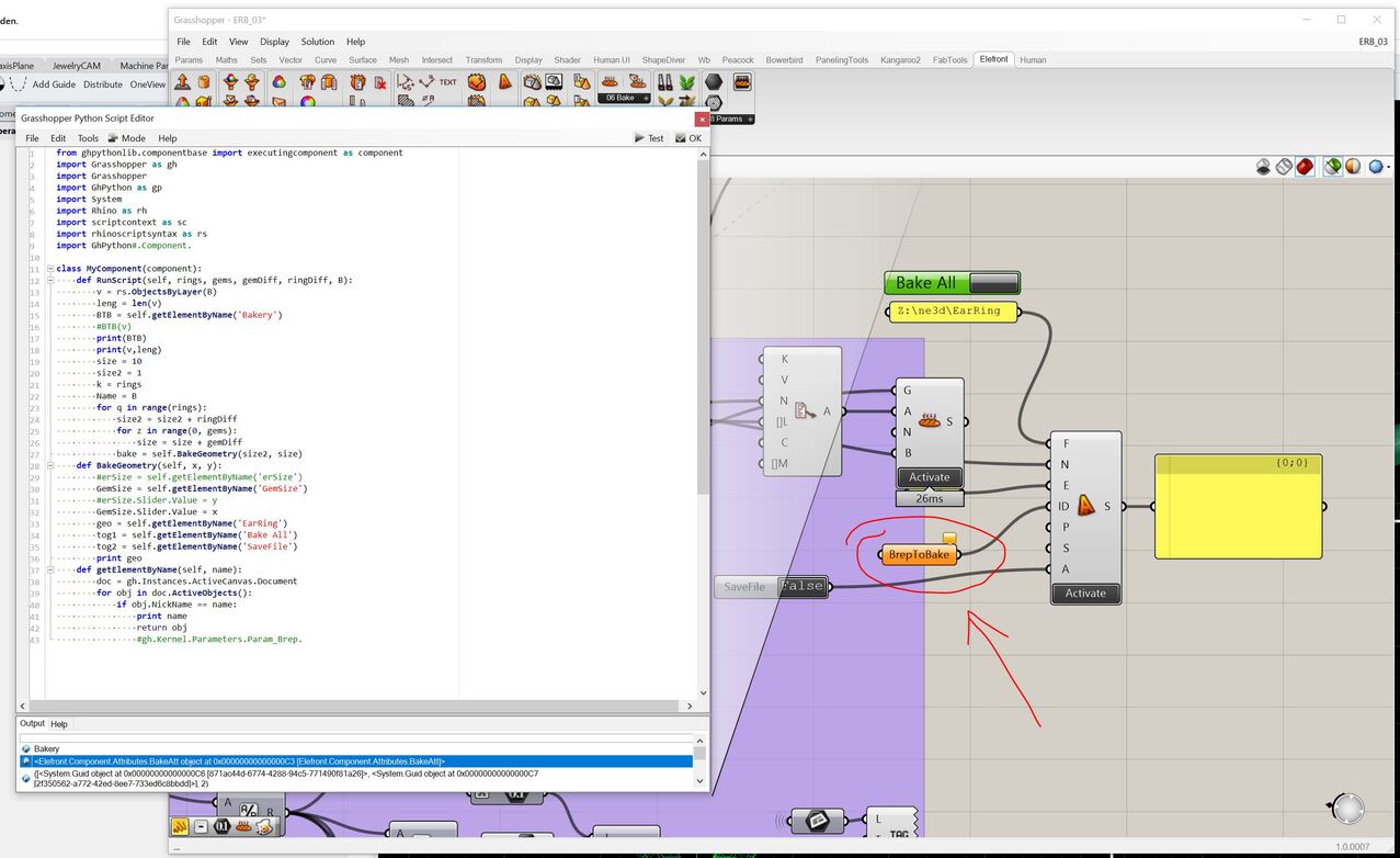

Im working right now on script witch should to save some different sizes of item into STP, or STL file sequence. However im new to GH python. And know a very little about type parameters.
I can find my empty Brep node (marked with red on image), and Baked from GH objects in the Active Rhino doc. Just can`t find a way to append found object to mine Brep node which empty and is in GH doc.
