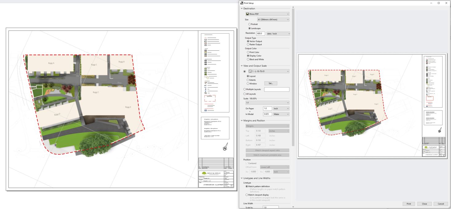

Ok, here’s what the dialog looks like:
All looks good.

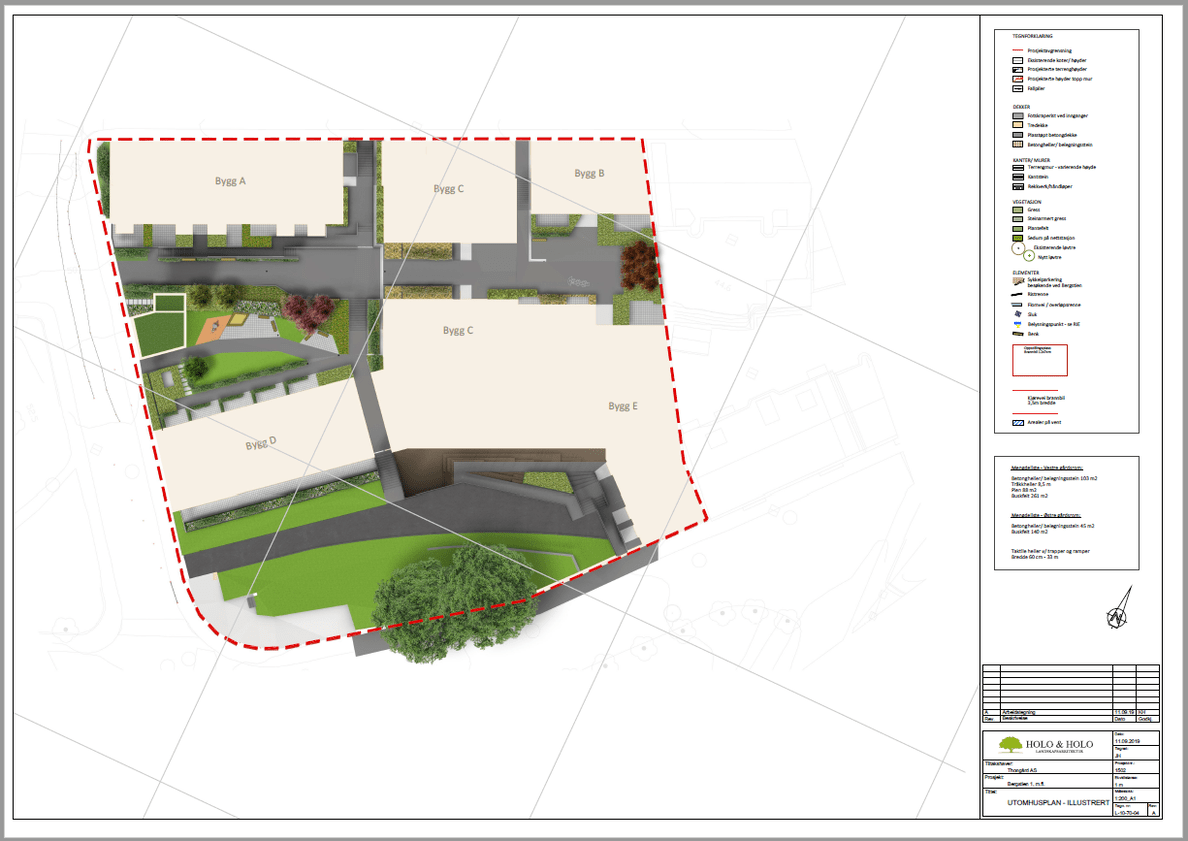

And this is the typical offset in the final PDF:
