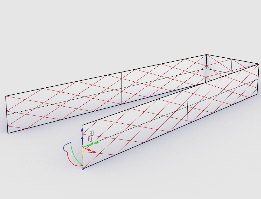

Hello guys, i need to apply diamond panels on different surfaces but when i do that the UV are different for each surface so it become a mess, i need to unify this process. I tried Surface Morph but it didn’t work, do you have any suggestions?

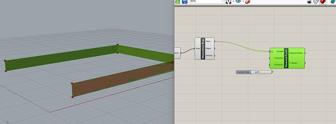

If I understood your objective, you are looking for a way to create diamond panels that are equal in size despite a change in the surface dimensions, you can always use the Analysis>surface Dimensions to build your divisions from that. see attached.
Diamonds.gh (11.3 KB)
Yes that’s exactly what i meant :slight_smile: thank you Tay
