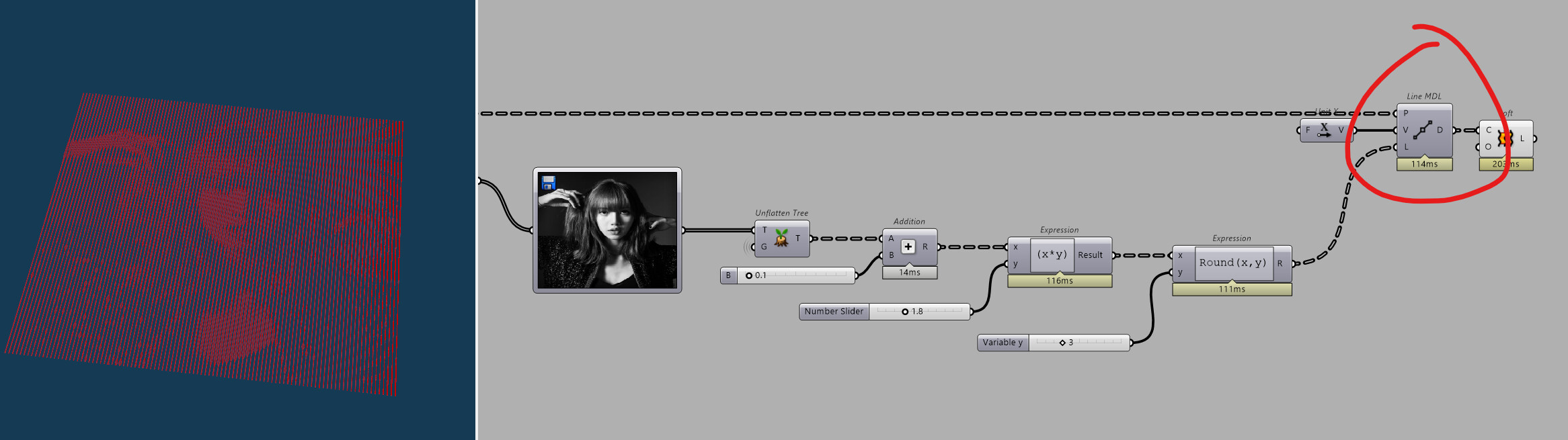

Hello, here is a file I’m working on. I got it from a tutorial. So I re-made it but I’d like to round up the diameters of the circle (1st question) then I’d like to read the diameter into each circle.
immagine cerchi.gh (375.6 KB)
Is it possible?
Is it possible?
you could round to decimal place with something like A, and show values with something like B:
immagine cerchi_round_and_show.gh (380.8 KB)
