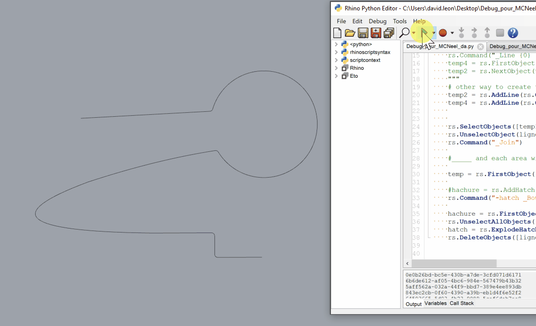

Hello all,
I have develloped a python script that follow a line and will create a lot of small hatch zone. For all hatch, I want to control the rotation, but some time the value of angle is counterclockwise and some time clockwise. If I select the hatch and try to change the value, the hatch stay counterclock or clock depending of what it was. And if I create the hatch in the closed curve with the command _hatch outside of the EditPythonScript, it will be always counterclockwise. Below, a picture of my problem! Do you have an idea to fix my probleme please? Thanks in advance.

You can find attached a script and a 3dm file to see the problem. In the 3dm file, I have put three time the same line, because depending on the position of the curve, the result is
different. And to create the line temp2 and temp4 in the function creation_hachure(), depending of the use of “ rs.Command(“_Line”)” or the use of “rs.AddLine” I find different result too.

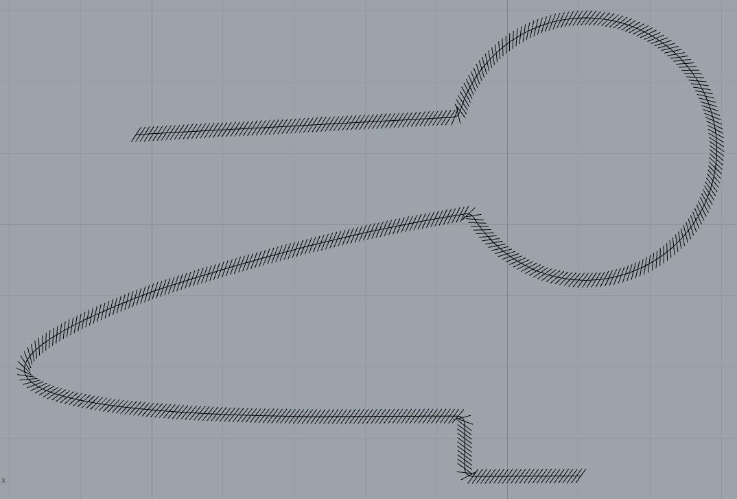

What I want is a different hatching in a zone around a line with different rotations each time. But I need to have this hatching on limited lengths, so it’s why I start to create little area around the line, that I will complete with hatch, as you can see in the video. But the problem is that even if the value of rotation is the same in the code, as you can see in the video, the real value of rotation is varying. If I try the same thing with rs.Command("_Hatch"), all the value of rotation will be good, but this way is not easy to use with an important number of hatching, it’s why I want to run the code with the function rs.AddHatch.

Is this the result you need?
I can’t explain in details why I need this hatch sorry. What you propose it’s not what I need, because I need always the same orientation of hatch, not depending of the line, but depending of the axes X,Y.
But I’m interested of the code that you have used to do that, perhaps I can find a way to do what I want.
@mdecultot you can try scripting the Hatch command instead of using rs.Addhatch:
rs.Command("-hatch _Boundary=No _Enter _Pattern {} _Rotation {} _Scale {} _Enter".format("Hachures1", angle, pitch)) #<--- use command instead of rs function
Debug_pour_MCNeel_da.py (1.9 KB)
that should work like you expect.
