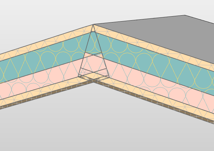

roof from curves

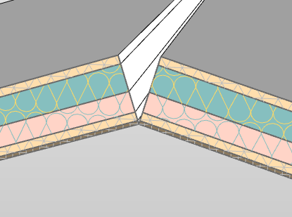

roof from surfaces - bottom alignment

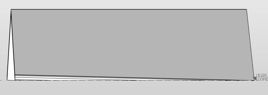

roof from surfaces - top alignment

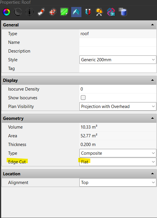

You can fix that by going into the Roof Properties and setting the Edge Cut to Flat. That should make the overhangs align properly with the ground level.

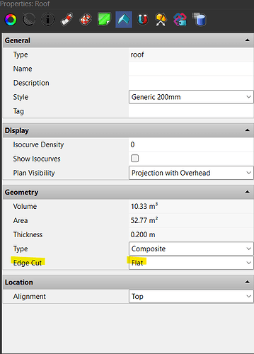

When I use the “roof from curves” tool, everything works fine at the ridge, but the eaves line ends up tilted instead of staying level with the ground. This only happens when I use the “roof from surfaces” option.
I tried setting the edge cuts to horizontal, but it still doesn’t come out right:
I meant to say ‘Roof from Surfaces’, not ‘Roof from Curves’. Sorry
