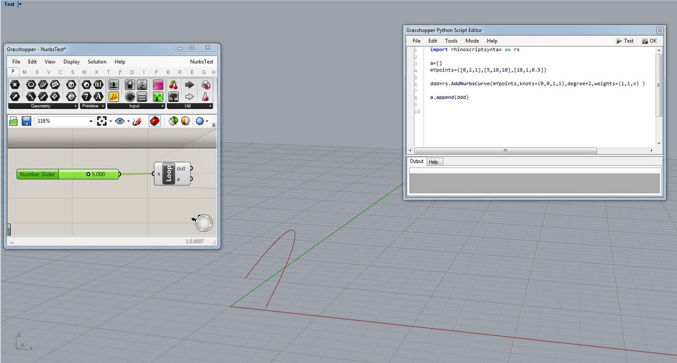

In Rhino 6 “rs.AddNurbsCurve()” doesn’t seem to behave the same way as it did in Rhino 5 when dealing with weights.
Can someone confirm this is a bug? or am i missing something?
I have attached the GH file. In Rhino 5 It works as intended.
NurbsTest.gh (2.6 KB)

@dale Does RhinoScript “rs.AddNurbsCurve” need to be updated to match the result coming from common (which matches the GH “Nurbs Curve PWK”)?
