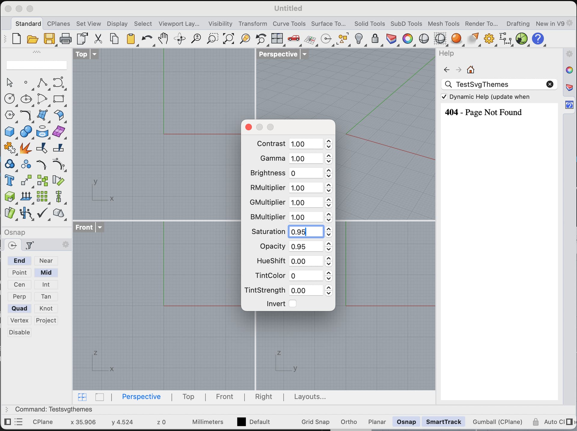

I’ve taken a few attempts at allowing for Rhino-wise customisation of icons and it’s quite a tricky problem to solve elegantly for a number of reasons. I did however have a simple idea that you can try out, it’ll be in the latest Rhino 9 WIP, the command is TestSvgThemes, it gives you a small panel that lets you tune the icons like a TV. It’s not perfect, it’s not persistent between sessions, but I’m hoping it helps us/me figure out how best to enable customisation.

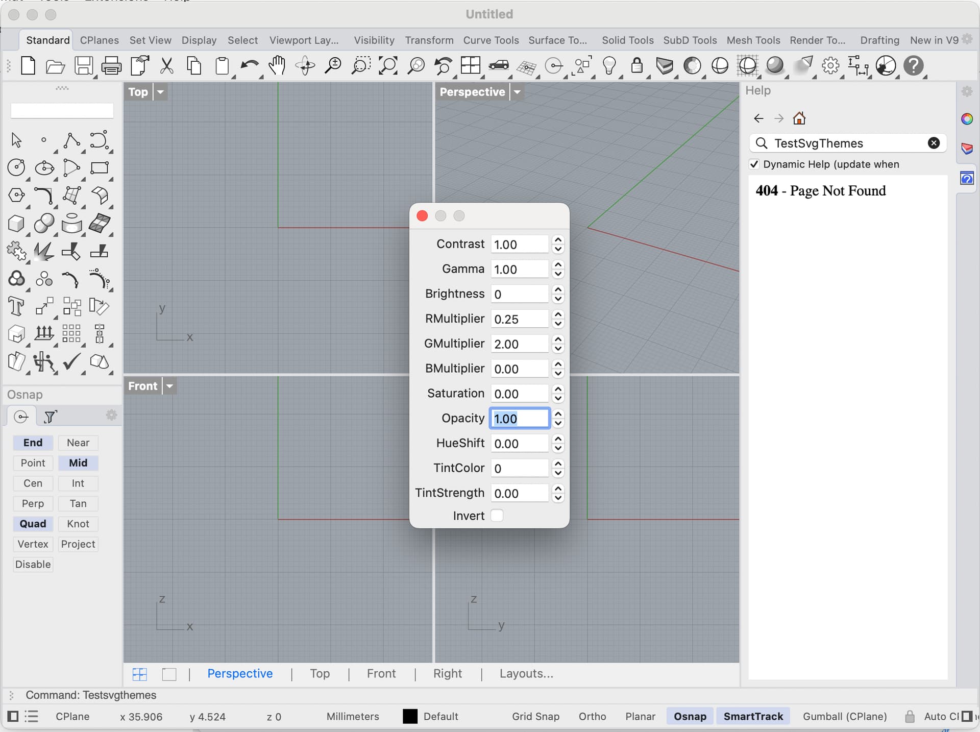

These settings let you make rhino Grayscale, if colour isn’t your thing
If you think the icons are too saturated you can knock down the saturation and/or opacity
I found a combination of settings I like that makes rhino look quite e-ink (to my eyes anyway)

These would recolour if they redrew, which I’m unsure when they do. The command tells Toolbar icons to redraw. If the settings saved a restart would fix this.
The filters should recolour EVERY svg icon in Rhino.
