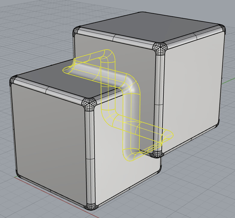

FilletSrf and ChamferSrf - continue across tangent faces
In Rhino WIP, these commands have a new option to continue the fillets if adjacent faces are tangent. This speeds up making adjacent fillets tremendously, especially in cases where the faces are not exactly tangent. In that case, the fillet surfaces will be adjusted where their edges meet to close any small gaps between surfaces.

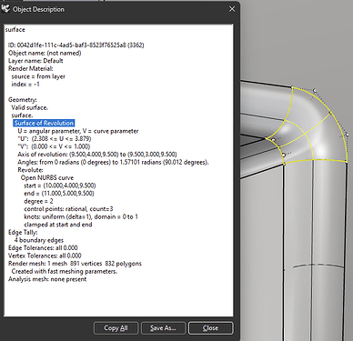

FilletSrf and ChamferSrf - simplify to revolve surfaces
In addition to FilletEdge and BlendEdge that already do this, now also FilletSrf, ChamferSrf will make revolved surfaces where that makes sense. Revolved surfaces are usually simpler in their control point structure and communicate a clear design intent.

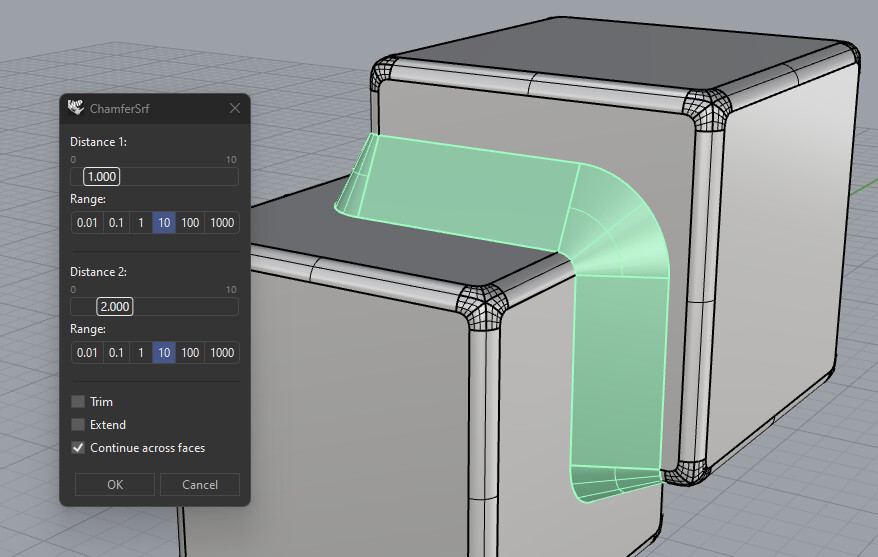

ChamferSrf - interactive UI
In Rhino WIP, ChamferSrf has been given the same make-over as FilletSrf got in Rhino 8: an interactive user interface with sliders to control the distances of the chamfer from the edge surfaces.

FilletSrf does this:
ChamferSrf should do the same when using different distances, but currently is plagued by a bug RH-87998 when some different distances are used, I’ll look at that soon. Having said that, it does work ā€œsometimesā€:
Any possibility to implement numbers 1 and 2 representing the two distances in the pop-up menu?
