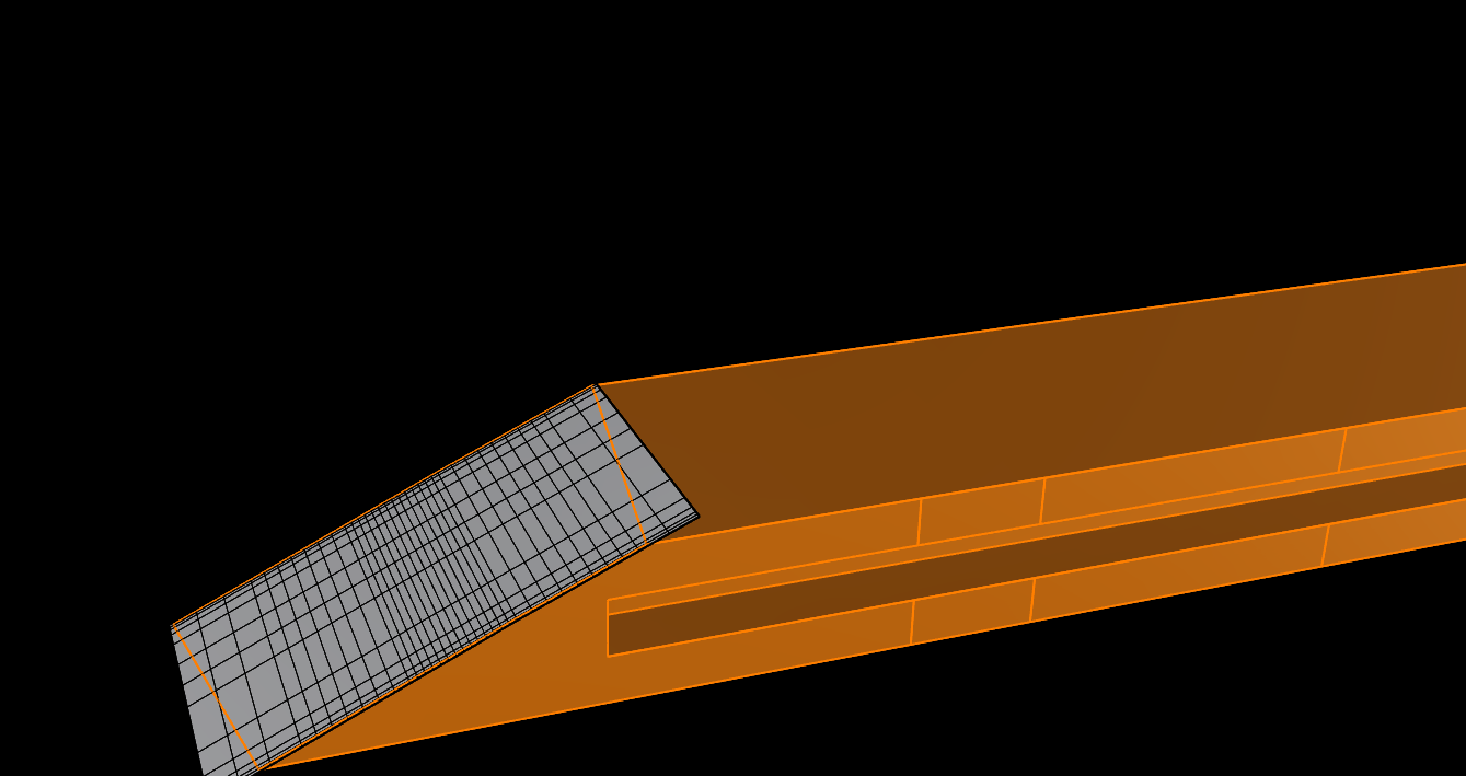

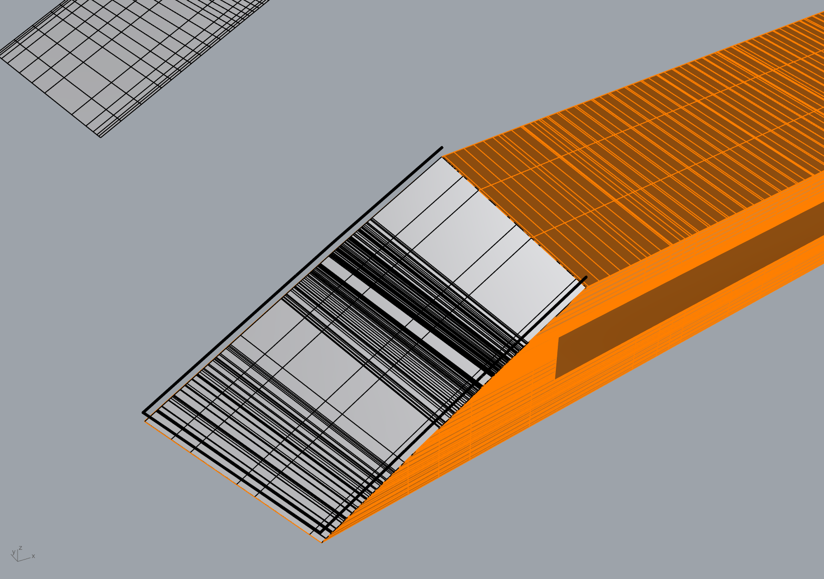

rhino 9 patch test.3dm (3.3 MB)
It doesn’t work well for me
There is not enough information here.
The orange surfaces do not fully intersect the grey surface. So at this point only 3 edges can be cut into the grey surface.
What is the result that is asked for here? Is there any reason not to use a 4 sided surface to create the grey patch?
It is also a bit of concern that so many control points are being used for relatively simple shapes. The curves that these surfaces were made from seem overly complicated. This will cause problems that more the surfacs are used.
