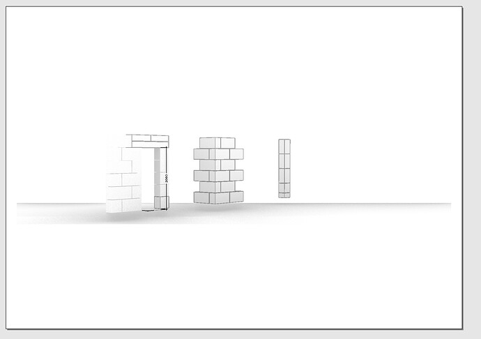

  3. Ground plane in perspective views in detail layouts does shows the groundplane horizon wrong.

And the ground plane bug in detail / layout
Testing in 8.6 is Ok, i’m assuming this was one of the items fixed in 8.5 related to printing.
