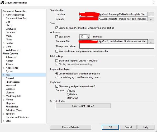

Hello All, Rhino 7 SR21 2022-7-27 (Rhino 7, 7.21.22208.13001) - Windows 10 as of 8-12-2022 I keep getting the “Save As” error 'cuz “File opened in read-only mode”. I followed this thread and tried to uncheck the File locking as per RH-59194 post in YouTrack. Any updates on how to fix it or I’m doing it wrong? I reinstalled it twice already but nothing seems to work so far - thanks.
Try checking the Enable File locking then uncheck the Display read-only open warning, then uncheck the Enable.
Thanks - I did what you suggested Japhy above, and problem persists. I’ve uninstalled my Rhino 7 and download the Trial version of 7 as well but the same issue is happening. What I just noticed is the following: I opened the file, work on it and I can save it once, then keep working on it but cannot save it a second time (Ctrl+S), and that’s when the “File Save Error” warning shows up and check the images below: If go to the file, right click>>> Properties>>>Security, The Permissions “disappear” after I try to save the same file a second time.
To make matters worse, If I keep saving the file a second time with another name so that to avoid the “File Save Error” the Group or user names: also change, and the check marks become darker.
So, the file needs to be saved “analogously” with different name.
Not sure who can shade some light into this, thanks.
