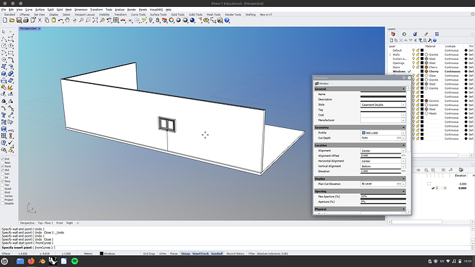

Since I haven’t seen anyone mention it, VisualARQ works fine. There are some visual heh bugs, but the it’s fully functional. You need to input the serial, cloud/network seems to be a bit bugged out.
