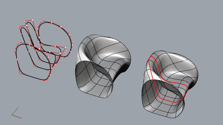

Hello, thanks.
How do I make the model below with just the seat and back more comfortable? just like in the review you did.
thanks
_Chair.3dm (1.1 MB)
Hello - I would start with three, or four, compatible, simple curve and loft them, then adjust the surface points directly to fine tune the shape - perhaps inserting knots (Symmetrical=Yes) to add a few more control points if needed say to soften the edges at the ‘arms’ of the chair.
Then slice it up to get the strips, don’t start from the strips.

Hello, I managed to achieve the desired result.
Another question arose, how do I insert some dowels to align the pieces, since it will be cut on the cnc router and turning the sheet is a bit complicated? 2 or 3 locations are enough to have alignment.
thanks
What size ‘dowels’? and where? perpendicular to the slices?
The dowel locations may have to change positions depending on the mating slices imo.
On the outward slices, maybe the lower end will be best but on the inward slices towards the midline, you’d maybe want some near the upper middle area.
The bottom might work for all slices since it’s probably flat and all flush.
8mm dowels, perpendicular to the slices and the random location, I think at the bottom because it is level, would just be to facilitate assembly.
