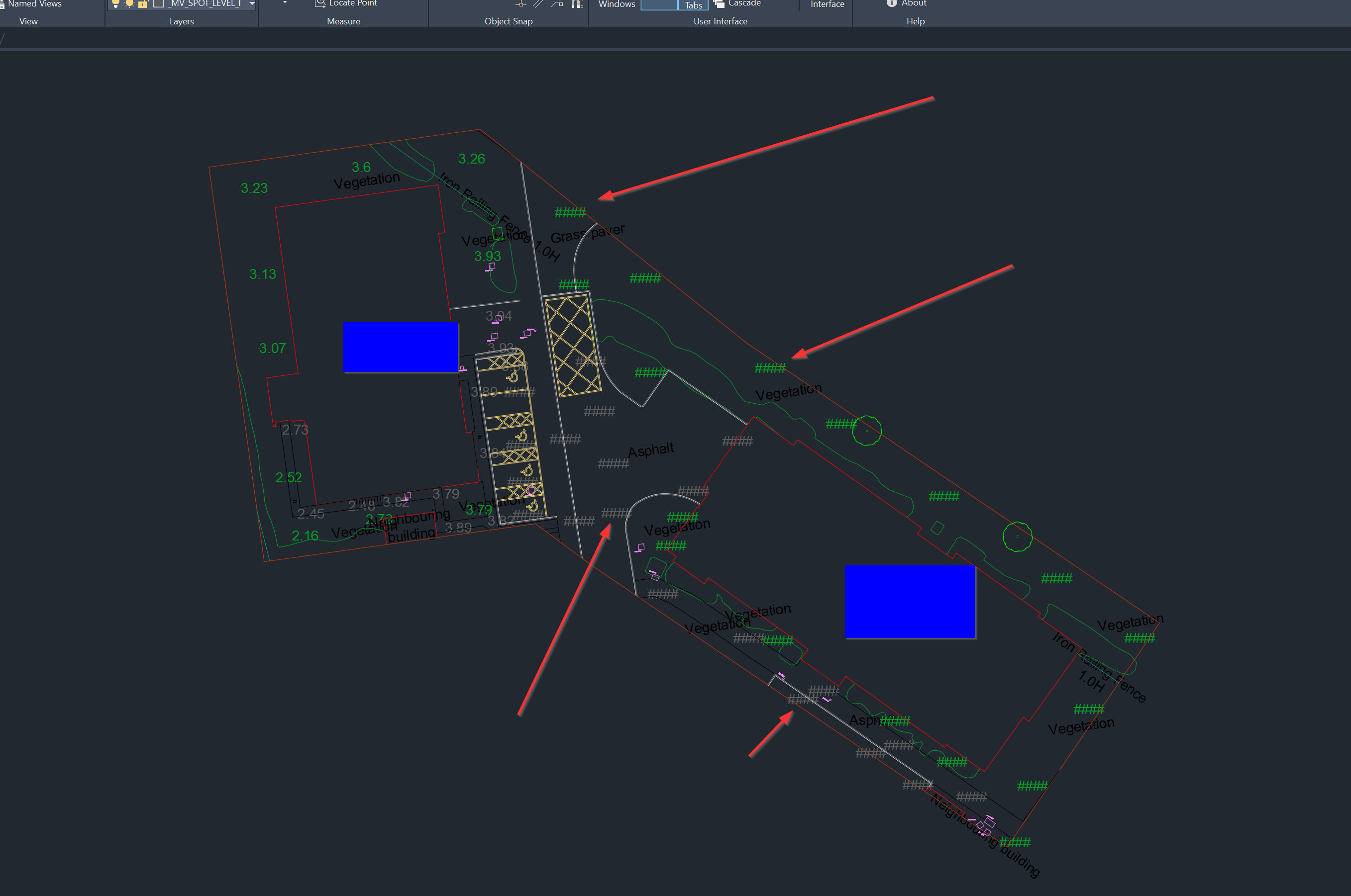

I created a block like you suggested, and it works fine, but only in Rhino. When I export files as dwg the heights are converted to ####.
Is it possible to export the real values? The numbers on the left side of the image are normal texts.

Thank you for your suggestion. Indeed, exploding the block allows to export the values and see them in Autocad.
What worries me is that is a rather drastic way. Afterall, you can’t revert exploing blocks later.
I wonder if there is possibility to keep the blocks and export the correct values.
One option would be to copy all the spot elevation/ spot coordinate blocks you want in your DWG export (e.g. by having them all on a layer and then duplicating this layer) and then explode the copied blocks while leaving your original dynamic blocks intact
