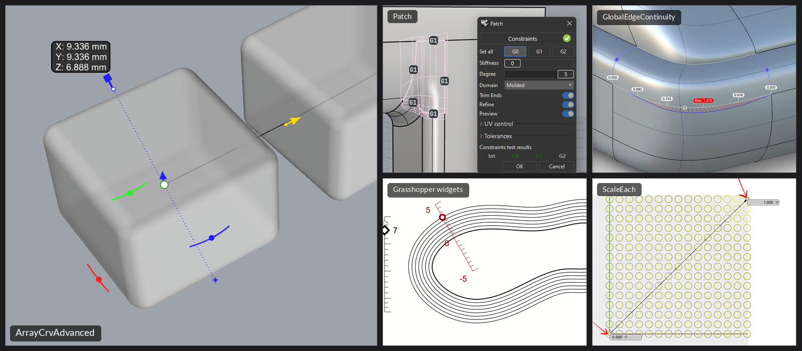

Rhino 9 adds an SDK for in-viewport user interface objects - widgets that draw inside a viewport and respond to the mouse. Instead of pushing users out to a command line or panel, you can put the control right next to what it controls.
We have been using this internally for a while now and feel it is worth mentioning. If you have run the Rhino 9 BETA you may have already used it:
  • ArrayCrvAdvanced - the on-curve span grips, the size and spacing arrows, the rotation/pitch/roll rings.
  • Patch - the continuity badges on each constraint curve; click to step through G0/G1/G2
  • GlobalEdgeContinuity - the numbered, color-coded dot at each evaluated edge; click one to select and zoom to that edge
  • ScaleEach / RotateEach - the in-viewport sliders you drag to set the start and end factor
  • SubDMatch - the bulge direction arrows
  • Markup - the whole floating tool HUD
  • Grasshopper's Curve Widget and Angular Widget components
  • EditHatchGradient - drag the gradient anchors and color stops right on the hatch
  • SetHatchBaseAndRotation - the on-screen protractor
