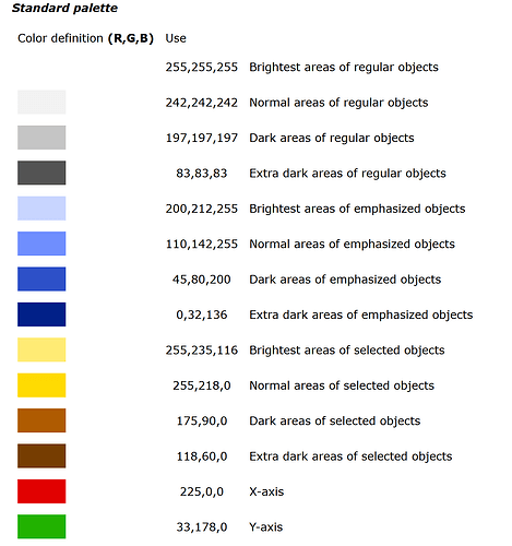

Re. defining the palette and the topic of colors & UI in general. It was illuminating to appreciate the work that went into establishing the color palette in Rhino we’re familiar with - from the Icon style guide that @martinsiegrist linked in another thread :
^^^ The classic Rhino spectrum right there. (Even green exists!). Notably this family stays well in the realm of the “primary” hues.
One thing about that group is that the way they present in Rhino is a result not just of their values, but their proportional distribution and the percieved contrast and saturation is highly relative to background settings.

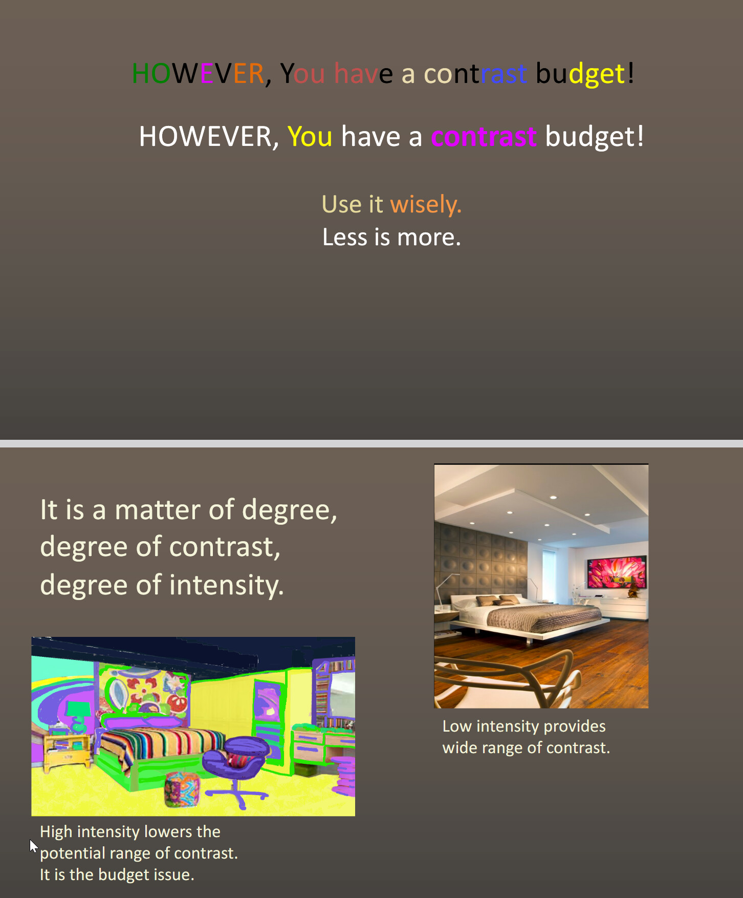

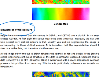

Notably - while folks with color blindness are the “canaries in the coalmine” so to speak - the same principles apply broadly to all human vision. We all have a finite contrast budget.
The bodies of research for computer visualization implore us to …
This site is a great learning resource from a team at the Texas Advanced Computer Center at University of Austin :
SciVisColor is a hub for research and resources related to color in scientific visualization. SciVisColor draws on expertise from the arts, computer science, data science, geoscience, mathematics, and the scientific visualization community to create tools and guides that enhance scientists’ ability to extract knowledge from their data.
… and this slide presentation from research scientist Francesca Samsel there :
… excerpt :
