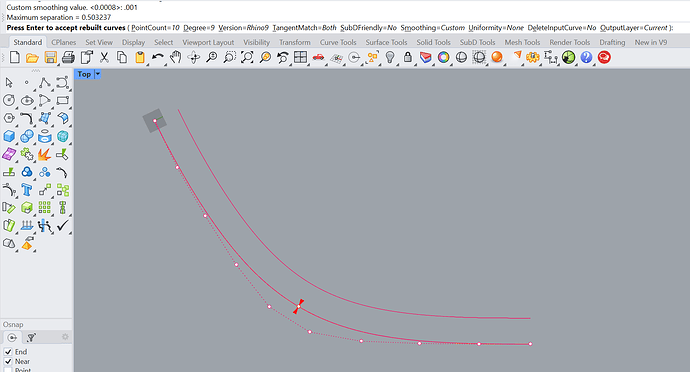

Original curves =
Elmo4.3dm (46.9 KB)
@mcvltd this is what I currently see, custom smoothing = 0.001
If you see something else, then I think you should get better results in the next WIP, which will be out soon

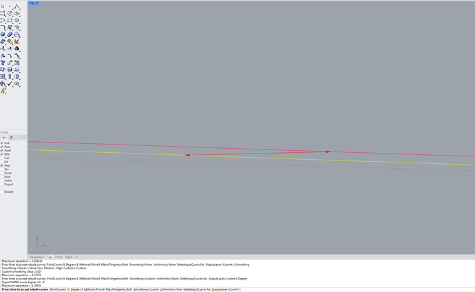

@Gijs Yes, I see something different…
with a zoom-in on that deviation below…
Looking forward to the next wip! In the meantime I’ll send all my work over to you… :wink: :grin:
actually, looking at your WIP, I missed that you were using a feb build, I think you should already be able to download a newer version that has this change in.
