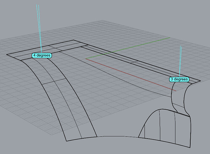

Another test: 5 edgs
Rhino Surface test1.3dm (15.3 MB)
This is an interesting model - there are normal deviations on two corners that make it more difficult for FillSrf and looks like xnurbs too. This means that whatever you try, the result will never be fully G1- or G2- continuous.
ouch, I didn’t check for that, but should have.
