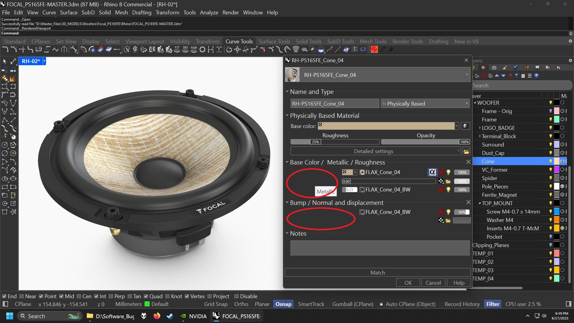

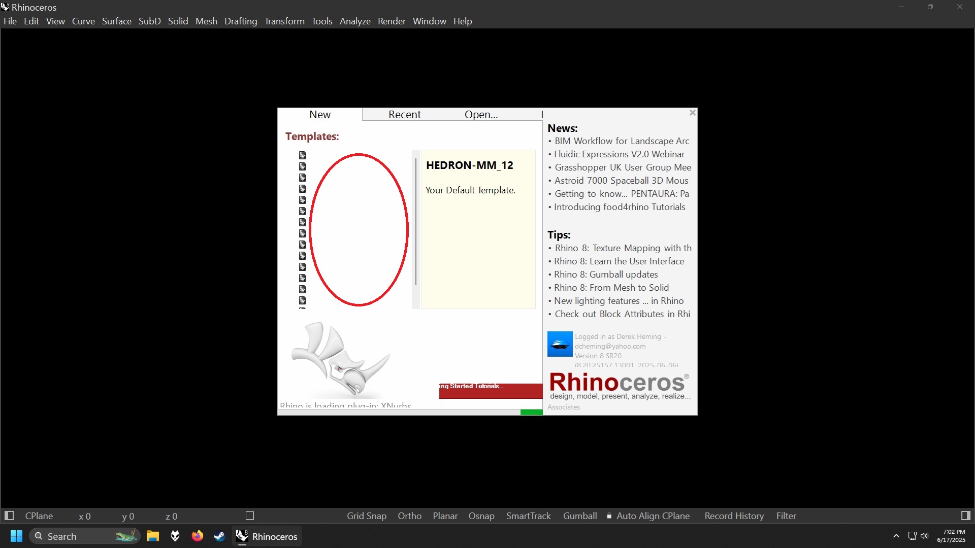

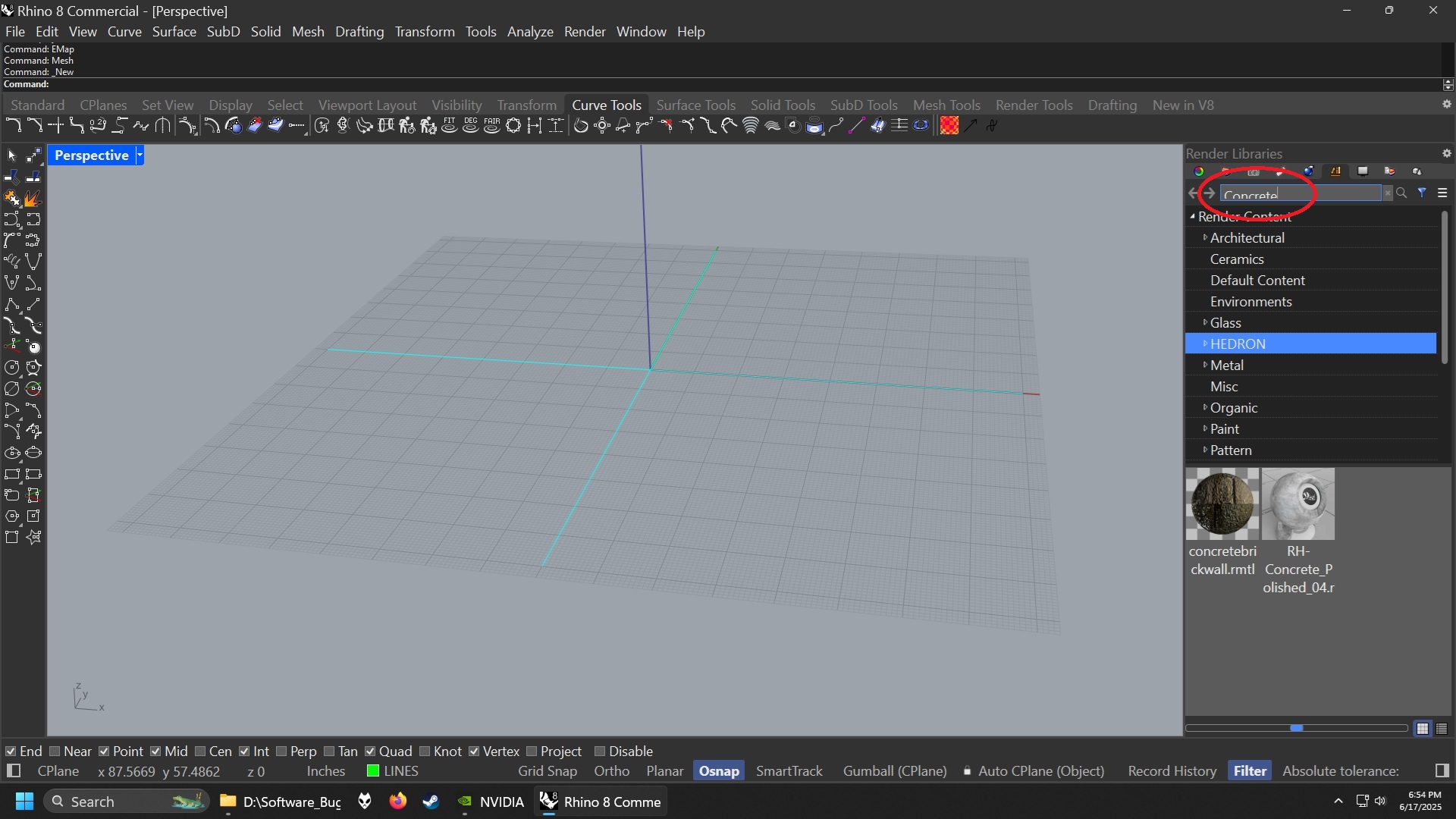

A while back (not exactly sure when, maybe SR6?) I noticed a weird issue where some of the system text in Rhino started becoming off center or missing completely:

This morning I was using Mp3tag to fix some tags in my music and I noticed some text was cut off there as well, exactly like what’s happening in Rhino. So I realized it’s probably a Windows thing, went to check Text size, and I had it set at 150% which helps a lot on my 24" 1080 display.
I changed it back to 100% and now everything everywhere works/displays as it should, but I’m back to squinting because of how small the text is. I’ll do some more research on this, but at least now I know the cause of the problem.
