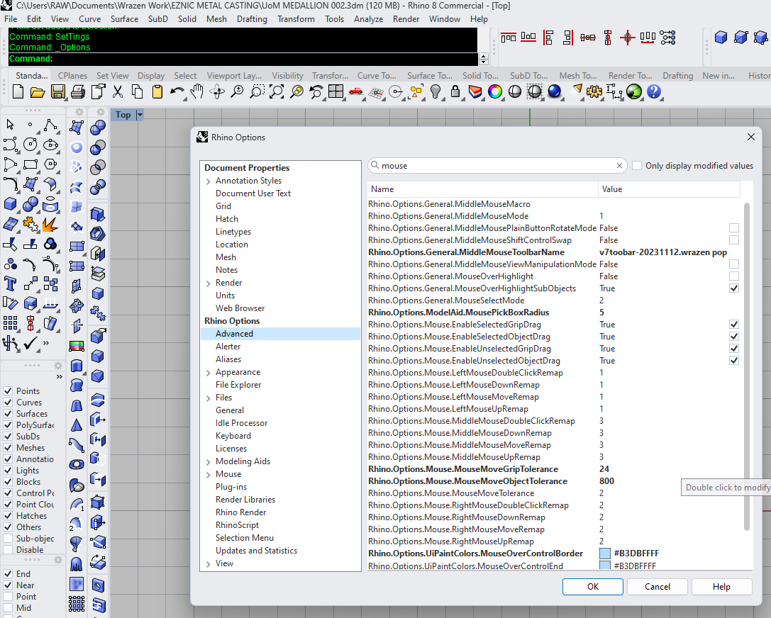

weird. Its impossible for me to select a dot in 8 unless i’m basically centered on it. And this is HEAVILY zoom related… zoom way out and the mouse pointer gets even further from ‘dot center’ so absolutely won’t select unless centered.
I think my advanced mouse settings are pretty standard, low mouse radius a/p how i had in 7… attached.

Hi Robert - does the same dot in an otherwise empty file select the same way?
Hi Pascal, yes same behavior.

Pascal, this def seems related to the file. I tried the test in a ‘no template’ scenario and I didn’t have the issue. In ‘my’ custom template I get the issue, attached here.
dot issues.3dm (6.0 MB)
Hi Robert - thanks - if I delete the layouts, it works… :man_shrugging:
I’ll get it on the heap…
RH-78771 Selection - dots and layouts
