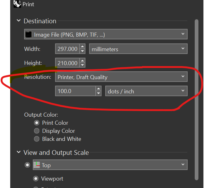

@Trav , another things which rhino should remember is Print Quality Setting for Image File
Now it switches to Draft Quality after each print.
Ahh yes, I see. It appears the main print resolution is contributing to the restoring of the last state issue. I can see some room for improvements here.
https://mcneel.myjetbrains.com/youtrack/issue/RH-83254/Print-Image-resolution-presets-not-saving-restoring-correctly
RH-83254 is fixed in Rhino 8 Service Release 11 Release Candidate
