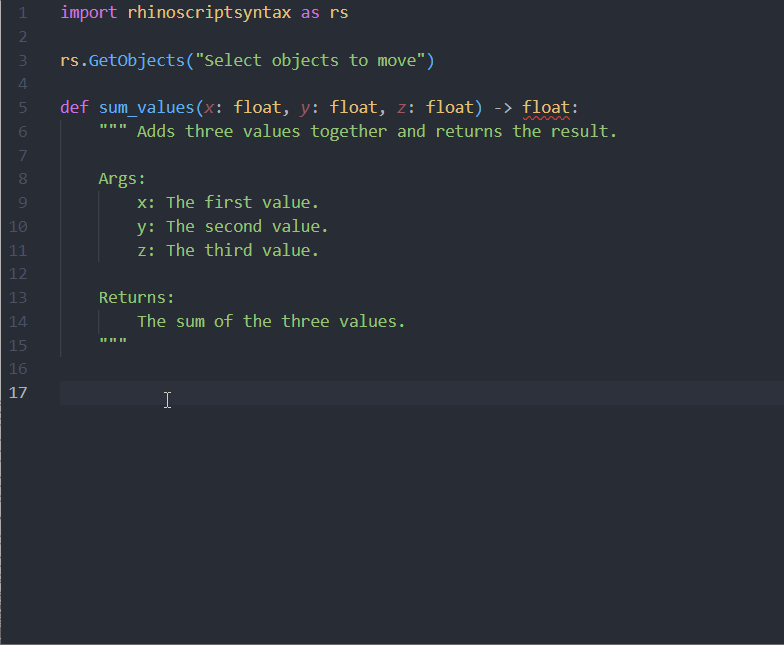

Docstring & type hint support
I’m excited to see the feature RH-58484 display docstring help when double-clicking a function name in the text editor
  • I’m curious if instead of double clicking if we could optionally have a window display on hover. I understand that some folks liked seeing it in the output panel of the legacy editor.
  • If this could work on user defined method docstrings it would be a great help for anyone importing their own packages as well.
  • Supporting type hints would also be amazing now that we have Python 3 support, and super helpful when prototyping with third party packages.
Here’s an example from VSCode:
docstring_help
Help TextBox
A separate item is the Help tab, if rhinoscriptsyntax help could behave similar to how the RhinoCommon method help displays in a new Help tab that would be amazing.
At least if the text box window could be adjustable and scrollable, that would be much easier than only scrolling each time you view help for a method, just resize 1 time and explore method docstrings.

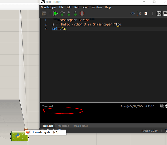

One quick design comment that I’m curious about is why syntax errors don’t appear in the Terminal tab. They show up in the component runtime message flag and highlighted in the editor and the Problems tab. That’s all good :clap: however when you’ve got a large script and your quickly debugging it’s nice to see the syntax errors in Terminal Tab.
Does anyone else agree?
