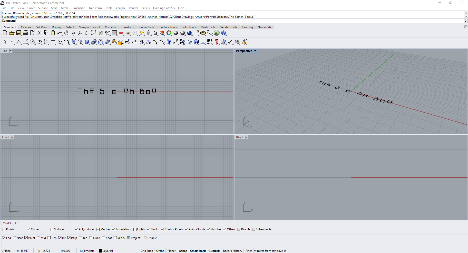

It still works in 5 but i am getting missing characters in 6.13
Tried it on multiple files and it fails every time.

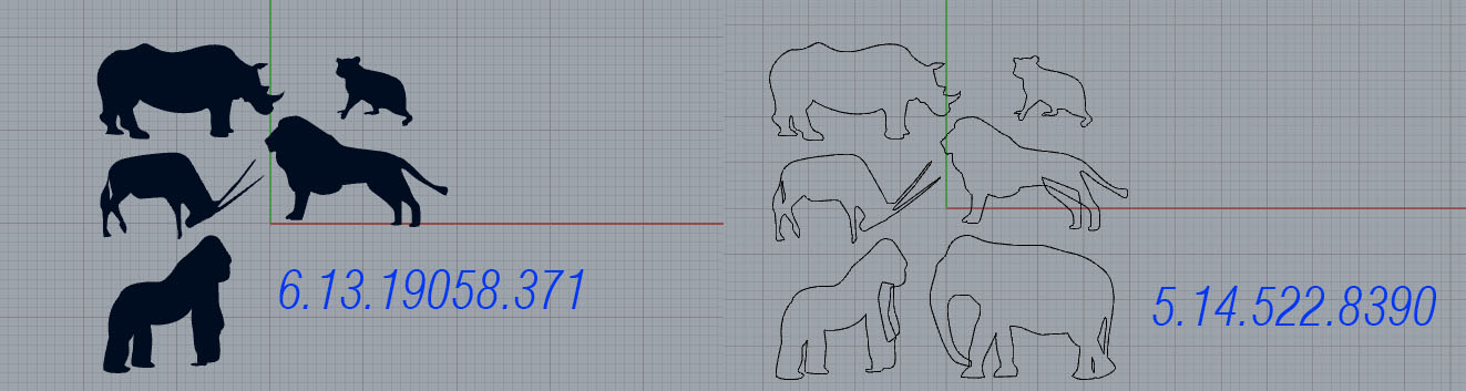

**Author:** ![AntonyNav](https://sea3.discourse-cdn.com/mcneel/user_avatar/discourse.mcneel.com/antonynav/32/559251_2.png) [@AntonyNav](https://discourse.mcneel.com/u/AntonyNav)\
**Post date:** [March 1, 2019, 5:10pm UTC](https://discourse.mcneel.com/t/rhino-6-13-ai-import-not-working/79491/5 "2019-03-01T17:10:44Z")
</div>
![elephantless](https://global.discourse-cdn.com/mcneel/original/3X/b/6/b6772972626d9c4164dd6eba066083fe58ea30cc.jpeg)
[96951-OLF3T7-288.zip](https://global.discourse-cdn.com/mcneel/uploads/default/original/3X/9/0/907e1f54779736741639e846406d481b519c1448.zip) (166.3 KB)

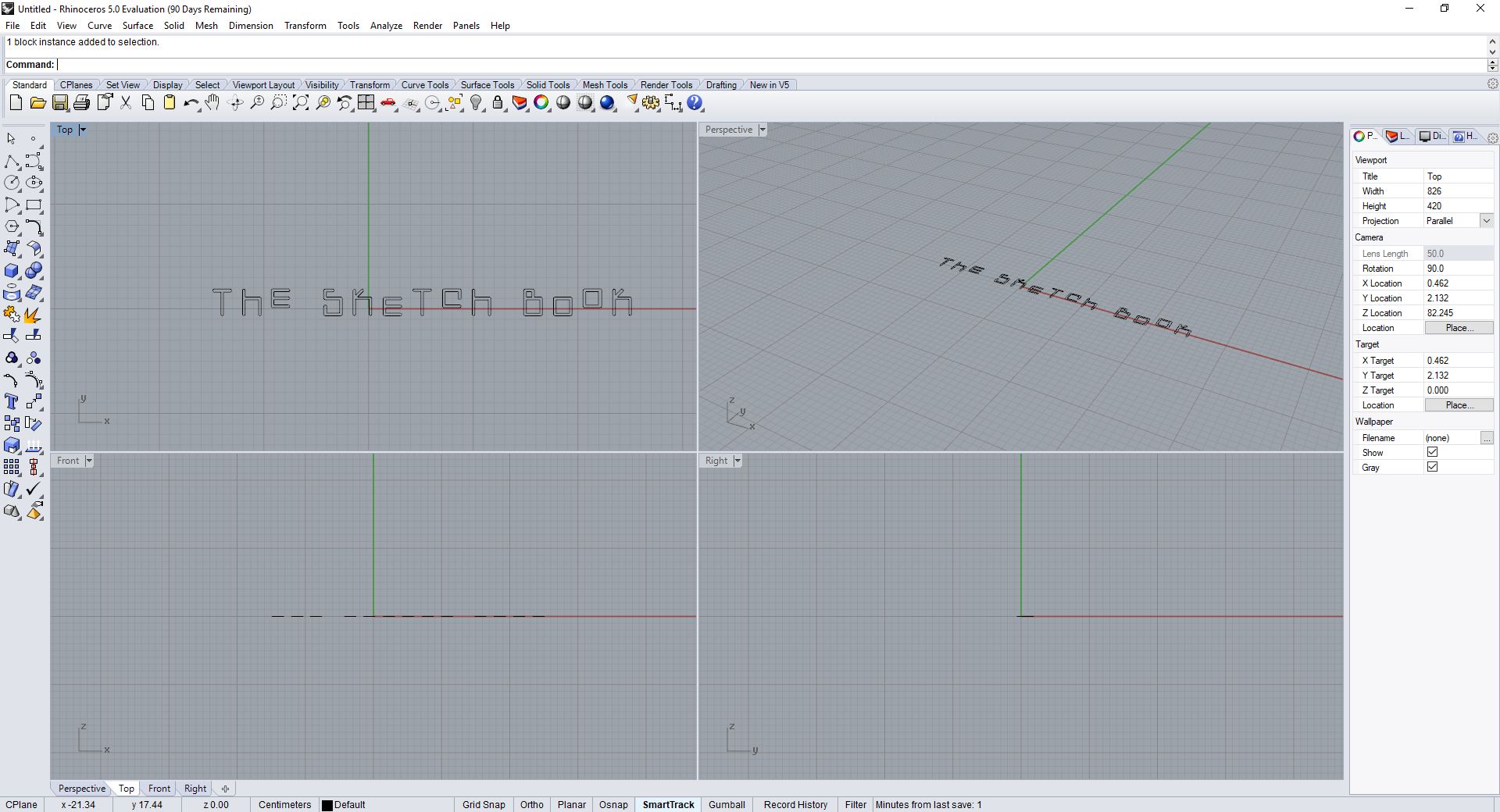

Thanks John,
V5
 ![v5](https://global.discourse-cdn.com/mcneel/original/3X/8/7/87294407116fae8dab228623b1ab1de0a1d16e51.png)
V6
 ![v6_13](https://global.discourse-cdn.com/mcneel/original/3X/9/3/9333bfe92256492523b3164c0a6e6c34808bb53e.png)

I do not use Illustrator and have little to no experience with using the files.
That said, when I open it in V5, I get outline curves, but they aren’t filled.
When I open it in V6, I get filled Hatches. That seems to be an improvement.
I can select the hatches and run DupBorders and get the same curves V5 has.
Do you have an AI file you can Zip with the text example?

Hello - I see that one curve is indeed missing in V6 if I import fills as hatches. The elephant has a self intersection, I suppose that is the problem with making it a hatch. I do not know why the option to bring in fills as curves is grayed out here… that seems buggy.
[https://mcneel.myjetbrains.com/youtrack/issue/RH-51348](https://mcneel.myjetbrains.com/youtrack/issue/RH-51348)
