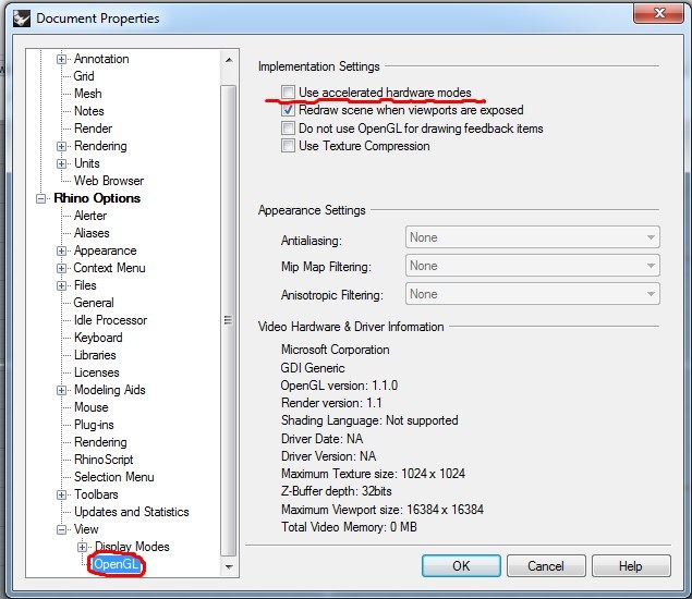

Hi guys, I have a problem with Rhino 5 for Windows. I think the real problem is GPU, i bought the new laptop one week ago and i install the rhino 5 but i have a big problem. I have two graphic cards, one is an intel family HD i think and the other is AMD radeon 8850m 2g. When i run the Rhino in safe mod it is runing good but i cant use it in that way. I found this video on YT, and I found it very similar to my problem I hope you find a solution for my problem, thank you.

Hey guys i forgot to post temporary solution fro the AMD - Intel gpu… I just disable my intel video card in device manager and my rhino now works fine. I hope I helped you :smile:

Hi there. I dont know how, but i do not have that problem anymore. But I know when the problem disappeared. It happened that disappeared when I did the following
This will work!!! just need to disable Use accelerated hardwer modes.
…But after a long time I have enabled accelerated hardware modes , and everything worked as it should and i dont know how :smiley:
I.T. did a driver update and so far it seems ok.

My best recommendation for a Radeon card is to turn off antialiasing in the Rhino OpenGL page. It looks like the Radeon group at AMD has no intentions on fixing the OpenGL problems with this card. They insist they are intended for DirectX and suggest the FirePro, much like Nvidia suggests the Quadro over the GeForce for OpenGL applications.

They (AMD) have a fix; to replace the Radeon with a FirePro.
One of our developers built an example for them to illustrate the problem they introduced into the Radeon drivers in December 2013/January 2014. The Radeon driver group said our users had the wrong card/chip and should get a FirePro instead. The FirePro driver group has been much better to work with.
