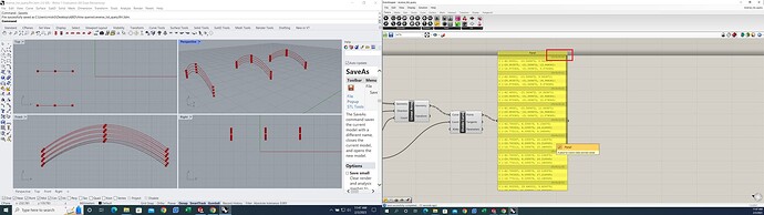

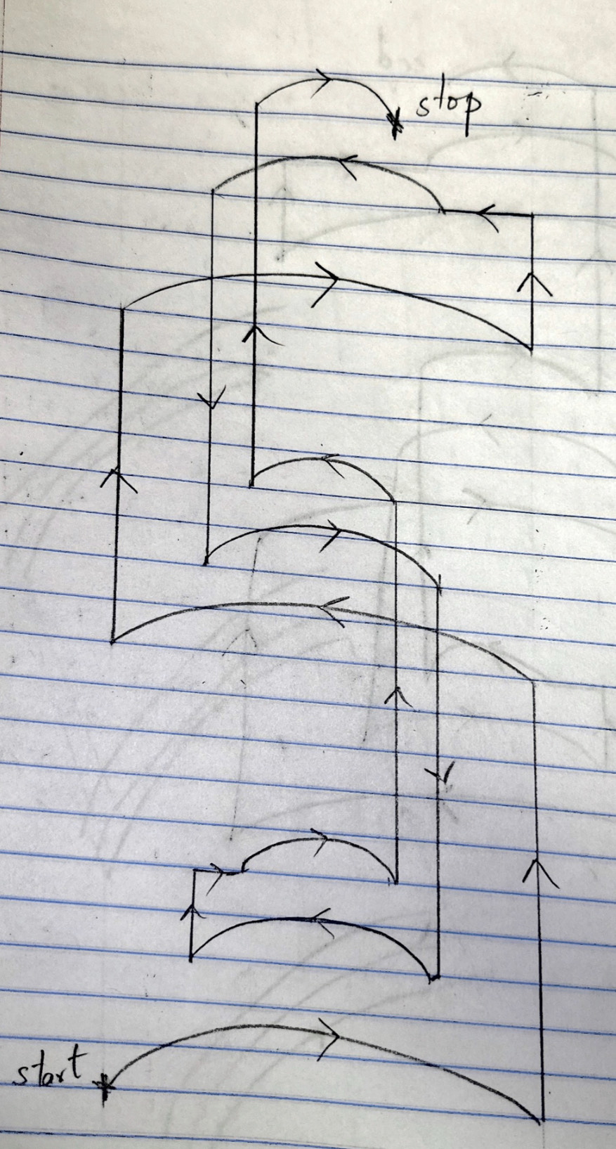

I have a list that gives me data as attached in the figure.I want to arrange this list in a specific format as shown in the hand written paper.
1.I want a list first arranged in that format.
2.I want to reverse every alternate sublist.
3.I want to reverse every alternate list in that sublist again.
4 I want all this in one single list as attached i the image.
(R) stands for reverse.
If I am not precise to explain what I want one can refer the hand written paper FORMAT NEEDED I have attached.
Can anyone help me do this ? Please ?
Thanks in advance. All the help is truly appreciated.
Hopefully this result is what you want to achieve with these manipulations… At least it made more sense to me than the thread title ! :sweat_smile:

But I want something like the image I have attached.
Although all the curves are of same size , I just reduced the size to have a better pictorial reperesentation of what I want.First we have the bigger layer , right above it smaller layer then above it the smallest one. Hope you can do it. Please.
Thanks in advance.
OK so the order is horizontal first and then layer by layer.
Flip Matrix solved it (and also there was an error for even numbers, that turned out to simplify the solution.
This should be working for any amount of tweens, levels, divisions !
