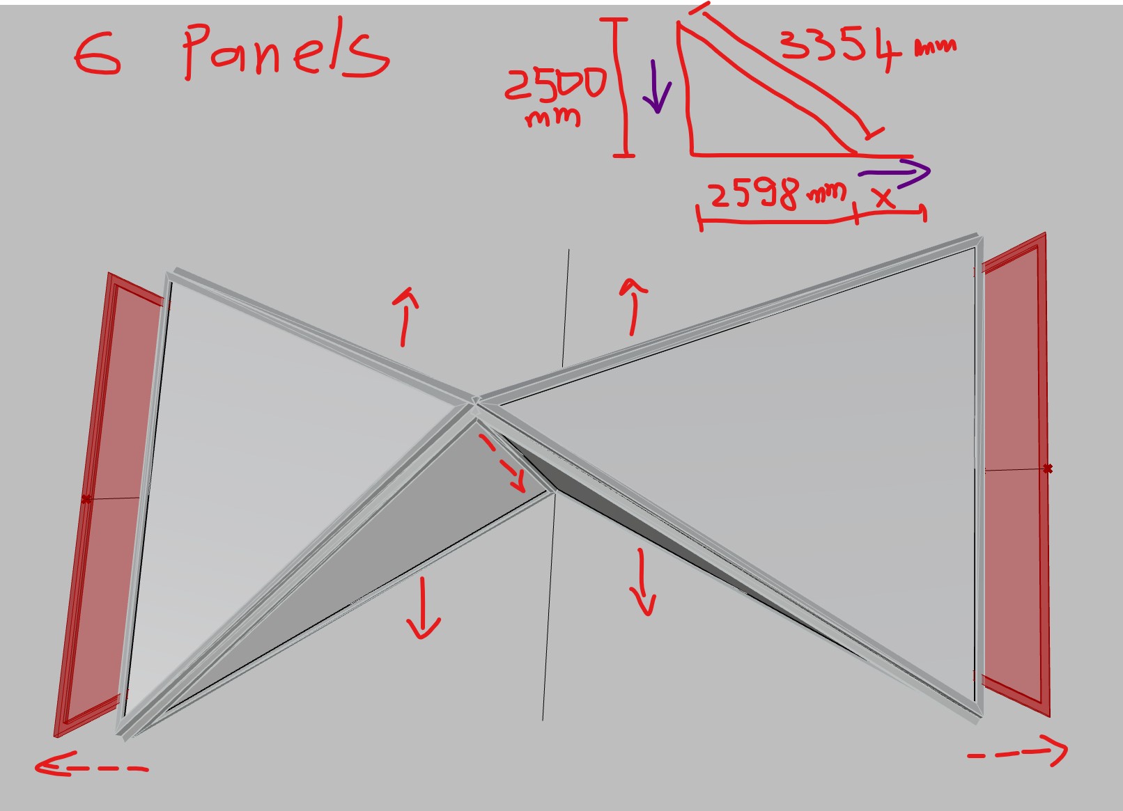

Greetings everyone, I have a complex design that I am trying to achieve and I might need your help with it. I have 6 panels that need to be retracted while rotating downward to close for all 6 panels, let’s say it is a kinetic window. I have tried my best to solve it but i am very far from achieving the result, so I need the help of experienced designers. Thank you very much for your time you will use for my case. All files are attached

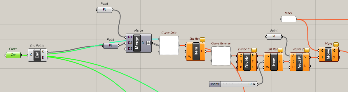

First, thank you very much for the quick reply. About the missing Plugins, Curve split , reverse curve, Plane rotate and block which contain the object. it should stop at the horizontal line end
First, thank you very much for the quick reply as well. I have mentioned the missing plugins just now, I don’t know whether you guys will have a substitute.

Sunglasses names the missing plugin components but that doesn’t make the code work. Can you please use standard GH components?
