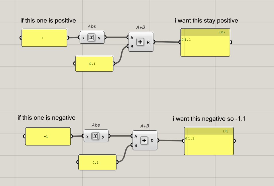

I need to link the result of this sum at the starting sign (positive/negative).
Any help?
Any help?

+1 / -1 is “A”
0.1 is “B”
Do an expression component with:
( A / Abs(A) ) * ( Abs(A) + B )
perfect! thanks a lot!
