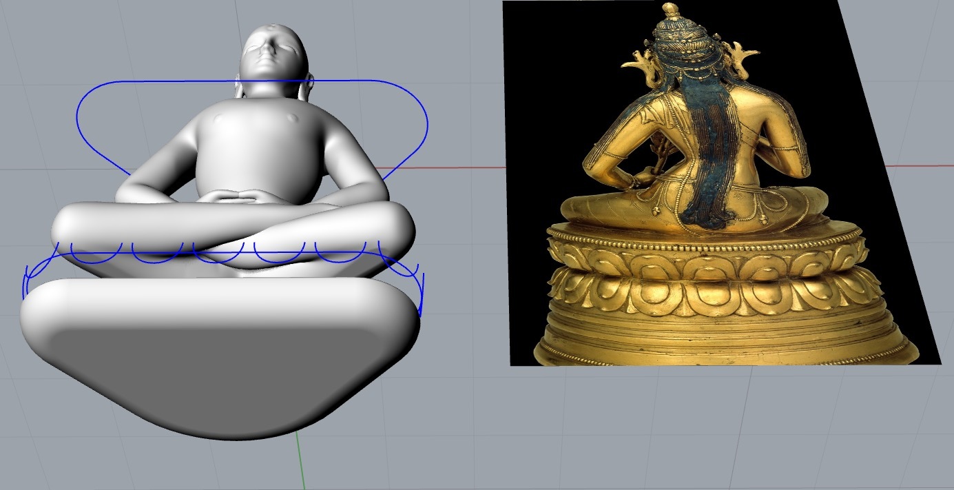

Hi guys,
I’m trying to model petals surrounding an irregular shaped base. I was thinking of arraying the curves, then projecting them onto the sides of the surface. This works with the model front on but isn’t working very well on the curved sides because of the irregular shape of the base…how would you model this so it looks like the image to the right? id really appreciate hearing any of your ideas!
 ![](https://global.discourse-cdn.com/mcneel/uploads/default/original/3X/b/3/b345b3861eaa14b4d950e0ab7908d8cdf0e6e308.jpg)
 ![](https://global.discourse-cdn.com/mcneel/uploads/default/original/3X/f/7/f75b4fd0971196f1837251f4e3045bb718eb95a1.jpg)[lotusthrone.3dm](https://global.discourse-cdn.com/mcneel/uploads/default/original/3X/2/7/27c68248dc0b13440cd6f4718a43551d5f09f6ad.3dm) (495.3 KB)

How about arraying after extruding into surface, then arraying it around the curve.
Using intersection command to get the intersecting curve between the closed surface
and the arrayed extruded surfaces?
[lotusthrone\_arrayalongcrv.3dm](https://global.discourse-cdn.com/mcneel/uploads/default/original/3X/4/0/40b67f69051eaca648c170bd8a9b137eec127266.3dm) (511.9 KB)

Hi Christian - see if the attached is what you need…[lotusthrone\_PG.3dm](https://global.discourse-cdn.com/mcneel/uploads/default/original/3X/6/0/6007c10c205de02e646fed30bc1240bffc733a12.3dm) (237.0 KB)
The idea is to make a single evenly parameterized surface where the curved surfaces are on your part.
- Shrink the surfaces (ShrinkTrimmedSrf)
- UntrimBorder
- I split the front straight surface in the center and shrunk the halves, to control where the seam point is on the resulting closed surface when the next few steps are done.
- MergeSrf each pair of surfaces, all the way around - Smooth=No.
- Rebuild the result to a good point count - I used 50 by 10, degree 3.
- CreateUVCrv
- Set up the pattern in the resulting rectangle
- ApplyCrv the rectangle and pattern back to the rebuilt surface.
The rebuilt surface can be discarded once the mapping is done and the curves Pulled to the original surfaces on the original object - do all your merging and rebuilding on a copy.
If you build the pattern as more complex objects - 3d curves or surfaces, use FlowAlongSrf to apply them to the surface.
