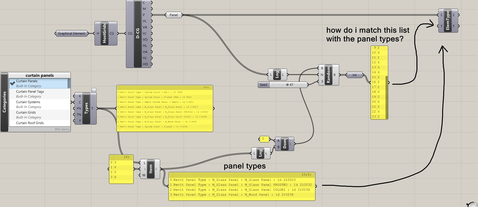

I have a curtainwall with 24 panels which i want to replace randomly with 4 different type panels.
I have the list of random numbers but I can’t seem to figure out how to match them with the panel types i want to repopulate the wall with.
Attaching a screenshot.
Any help would be greatly appreciated!

The randomized list you have generated is 5 items [0 to 4]. Ideally this would be 4 [0 to 3] per your panel type selection, then you would use the Random list output in a List item component on your 4 Panels Types.

Thank you Japhy!
it works. Had a feeling it’s something as silly as that… :upside_down_face:
