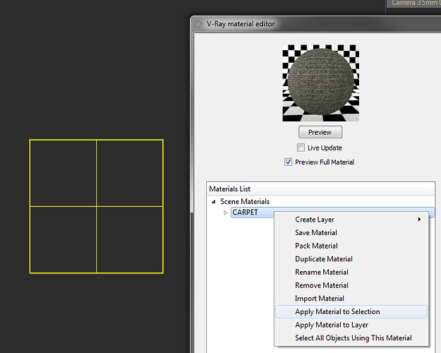

In the attached scene, when I use the “Apply material to selection” function in V-Ray’s material editor, Rhino crashes. Or it does when I go to the material section of the object’s properties.

I seem to be missing some of the TIFFs you are using, can you pack your scene and send the packed zip file.

I was unable to replicate the problem with the files you sent. We will look into it more, and maybe contact you for more information.
