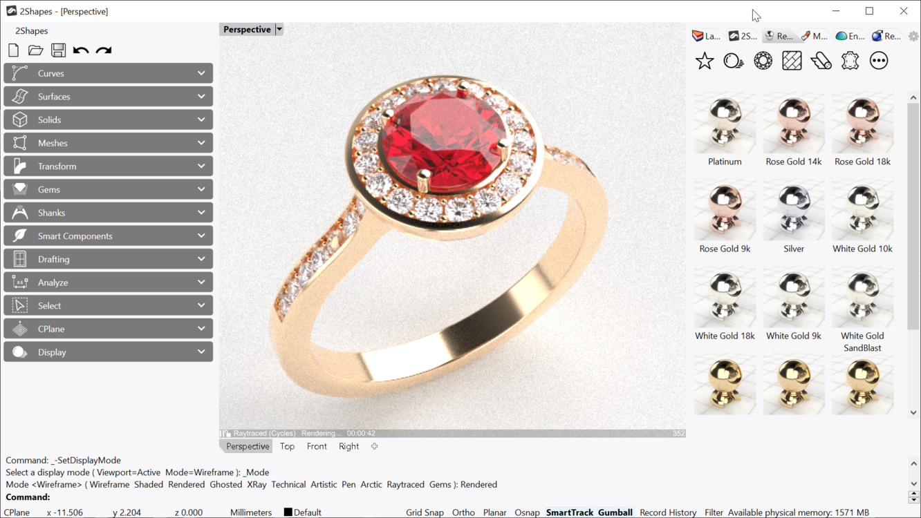

We are getting really nice results with Cycles in the viewport, but when I click on Render, I see Rhino Render in the dialog. I was checking Render, Set Current Render, but is not on the list.
The solution I found is ViewCaptureOnFile, but I don’t know if it the best solution.
What is the best way to render an 800x600 render with cycles? :slight_smile:

I’d use -ViewCaptureToFile and set the resolution as you want, as well as the number of passes you want to render at.
Cheers,
/Nathan Letwory
Raytraced integration developer
p.s. in Rhino WIP the Rhino Render is Cycles, so will be the same as Raytraced when pressing the render button.
