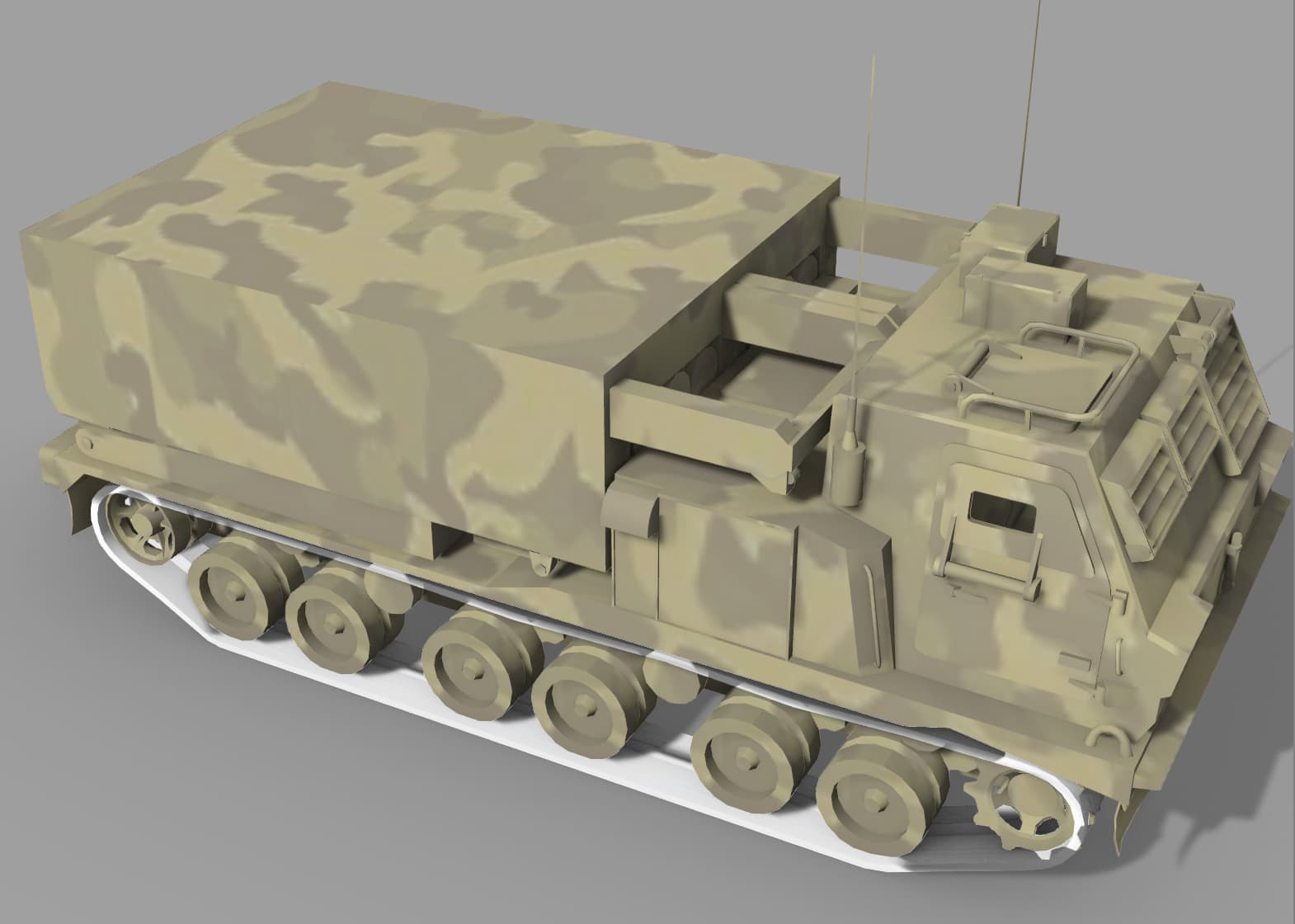

1.In the attached file the groundplane’s shadow shows through the object in rendered mode.
2.I can’t get the tank treads to be dark I even tried a different material from the library. This is in standard rendered view. It shows in cycles raytraced view fine.
I exported this tank file out of Unreal and no textures were exported but it did create the slots for them, and I tried to assign a new texture to the tank treads, but nothing gets darker in rendered view.
I’m seeing weird texturing display problems, in some of my display modes textures disappear on models where in another almost identical mode they appear and disappear on different models. While all of textures appear in rendered mode. Yet when importing this file it displays worse in rendered mode.

The mesh is a bit weird. Here goes for the main vehicle, but needs to be done for tracks too:
  1. _Copy, choose in place
  2. Rename the copy so you can differentiate from original, I chose to add unwrap_object to the end
  3. Select original object
  4. Run _RebuildMesh
  5. Go to object properties > texture mapping
  6. Select Custom Mapping (the duck icon)
  7. Select the copy mesh ([...]unwrap_object)
  8. Hide the copy
The rendered mode will look better. No weird white-ish objects. Below screenshot where man body is done, but the tracks haven’t been fixed yet.

To be sure I also logged a bug here: RH-68522 Shadow shows through model in Rendered mode
RH-68522 is fixed in Rhino 7 Service Release 18
