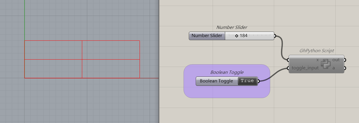

I had a Python script to control display.conduit in Rhino, using an input toggle to switch the display on or off in the viewport. This works as expected when the component is enabled.

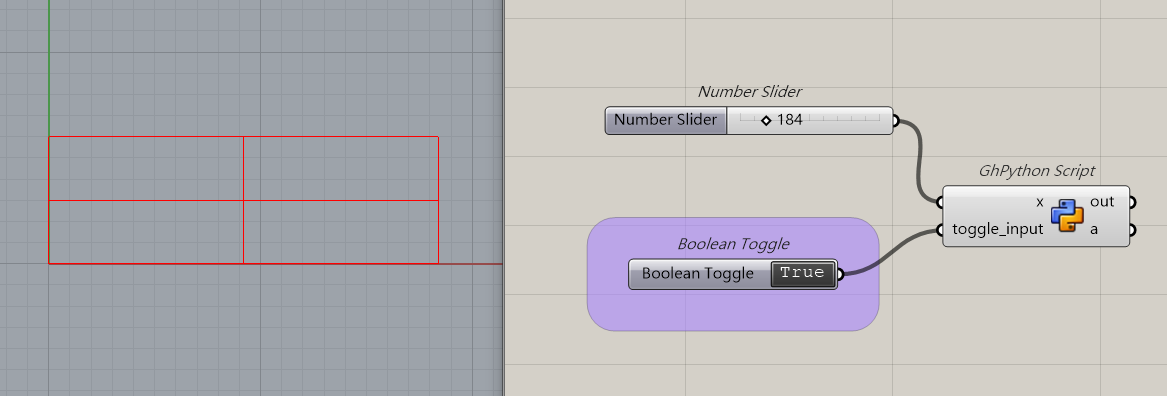

However, when I disable the Python component in the Grasshopper canvas, the conduit display remains visible in the viewport. In other words, the drawing stays on the screen even though the component is no longer active - the same issue occurs when toggling or closing the Grasshopper file.

Input toggle = True:

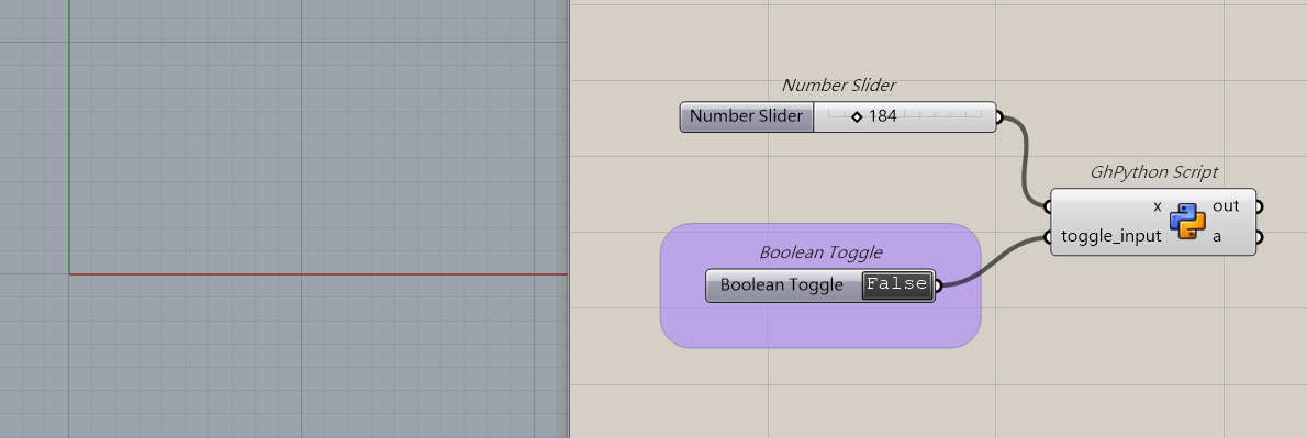

Input toggle = False:
Component = disable (Red-box still showing):
