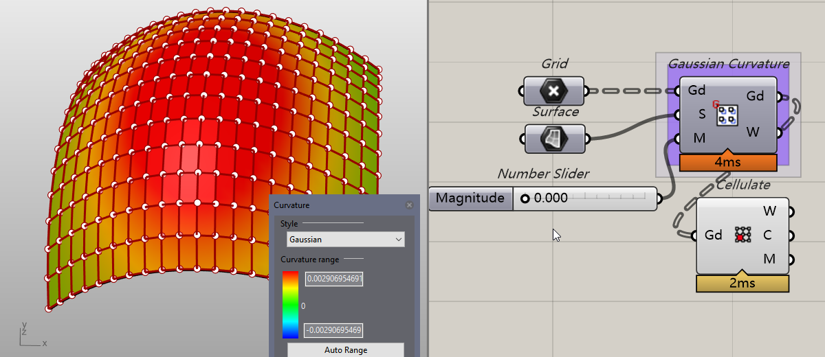

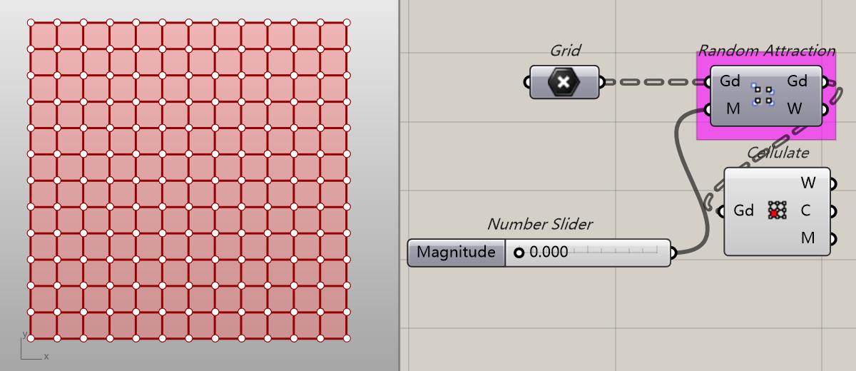

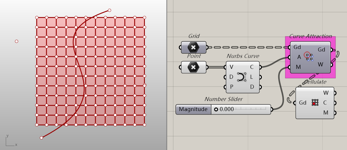

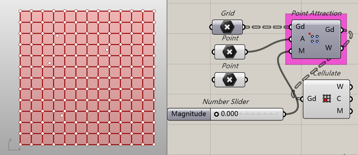

You can give it a try with PanelingTools, you can find a set of Grid Attractor components.
Curve Attraction
Point Attraction
Random Attraction
Gaussian Curvature
Weight Attraction
