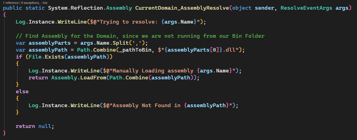

You should be able to use AssemblyLoadContext.Resolving
to figure out at runtime where to load an assembly from that could not be loaded.
