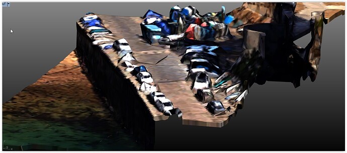

I’m creating a large scene with downloaed topographic meshes. These are really messy and contain a lot of vertical faces for example. As there are more parts of this coastline and even in this are already some hundred meshes, I’m looking for an way to automate the process of deleting stuff. I have managed to create a defiinition to delete the vertical faces that are below the surface. But how do I reapply the texture or maintain it on the surface?

Well … if - per disjoined Mesh - vertical faces (or Faces where their Normal VS the Plane.WorldXY.ZAxis angle is within some user defined Interval [say +85 to +95 [in degrees]) exist this means that an Edge has 3 adjacent Faces (BTW: non manifold Mesh) … so removing them is an entry level EF Connectivity thingy (no matter if they are “above” or “below” the good Mesh Faces).
All that in theory (that has rarely any relation VS reality). This means that if your Mesh is bananas > bananas is what you’ll get.
For the texture matter … is also easy but all my things are carried over solely via C# code (i.e. not a single component on sight). If you think that such a solution has meaning to you … provide a “small” test case (or better: several) in R5 Format.

BTW: the N2 (13mB) file is not in R5 Format … so let’s stick to N1: You mean that you want to “clean” the Mesh from … er … things in order to get only the Terrain ???
If yes … well … that requires SEVERAL lines of code (ideally a “learning machine” oriented solution).

Is possible … but requires rather too much work that may had a meaning if you had a vast N of Meshes day in day out (and Elon paying - perfect things have a certain price). For instance when a computer “sees” this:
he may thinlk that all are OK (and indeed the wall on the left may (or may not) be part of the terrain). But … there’s &#&#& cars (no proper Porsche on sight mind) mixed with car sized little rocks (and numerous other things):
Moral: I would stronly suggest the obvious
The cars and the other stuff is later almost invisble. Fine if they are only coloured spots. The walls and rocks should be there of course.
What do you mean by your suggestion?
You know it (but hope dies last) : do it the good old way: manual.
For instance imagine the amount of code (and the tests … and the other tests … blah, blah) in order to teach the idiot (the computer) about what is a tree (requires a Recursive “expansion” for a given “vertical” face following various freaky rules: for instance the top part of a tree … may look like a Terrain … but is a tree because has faces with slope > 90 plus has a %##$ trunk).
