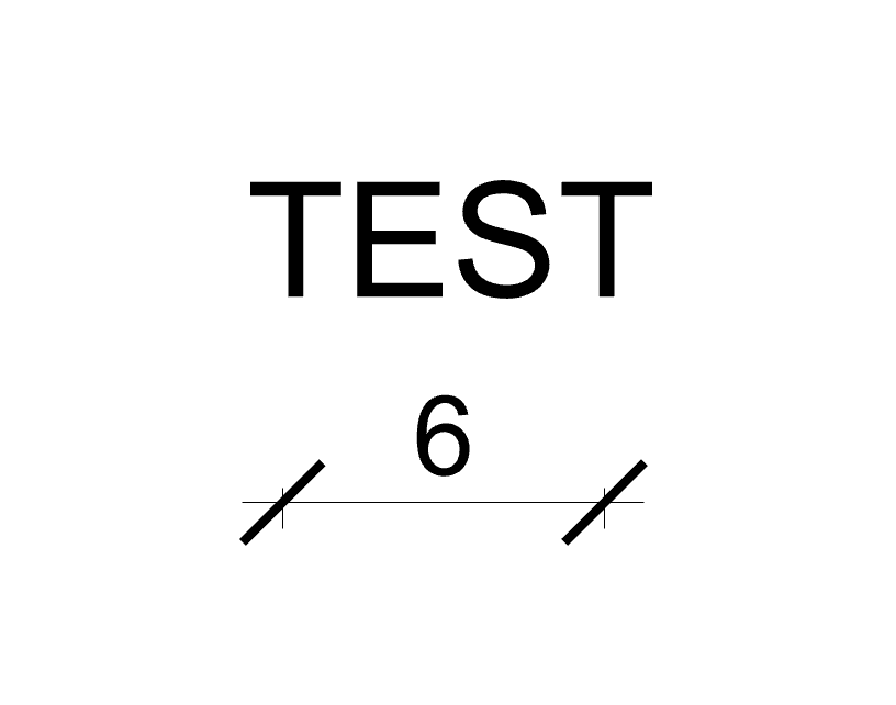

Dimension scaling is inconsistent when jumped inside and outside of block:
Outside
Inside
Below shows how I reproduced it:

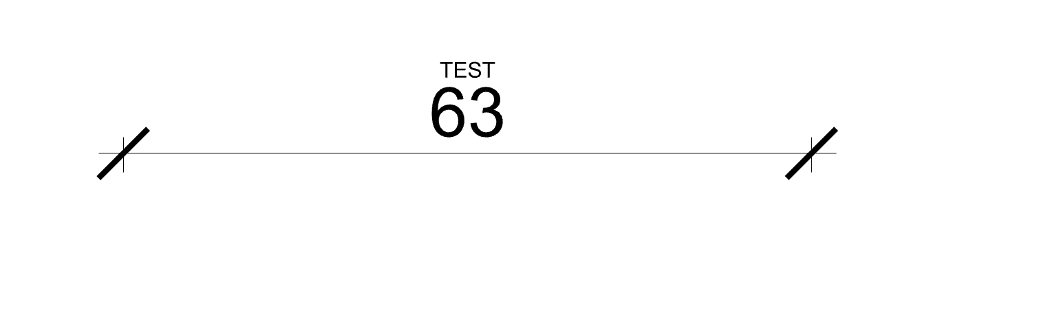

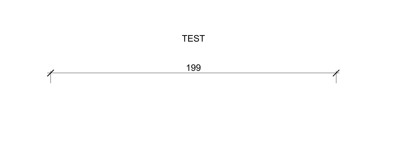

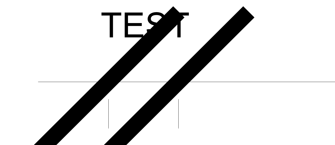

Another bug with the dimensions inside scaled block.
outside:
inside:
The dimension annotation inside a block is “frozen” when the block is scaled. In the Block-editing mode, the dimension annotation works again and gives the correct dimension.
The reason why we need this to work is because our team was trying to create a block that contains a lot of measurement in an architectural grid. However, scaling is required when the block is moved to another file which has different unit system.
All the dimensions inside the block no longer work as soon as the block is scaled.
