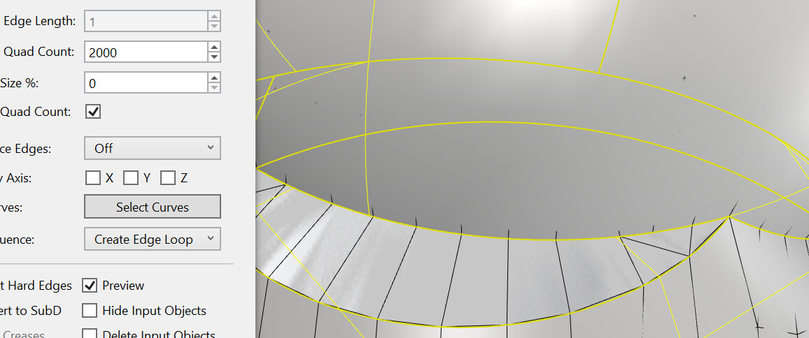

Triangles are not 100% avoided, edge detection not allways good.
Adaptive size 0%
AS0
Adaptive size 100%
AS100
Option “Use Surface Edges” are broken or unclear ?
OE
Set option to “Smart” Rhino says "Select Quad Mesh options !
Same with option “Strict”
Unselect “Preview” command line shows command as finished but QuadRemesh window is on top and active.
So, downgraded to “SR 7.12 Stable” and quad remeshing is more stable.
Option “Use Surface Edges” are worked here, but the feedback on command line needs fine tuning.

Hi eddi - I am still messing with this but in oor latest I get pretty clean results if I specify curves like so The marked edges) :
The same settings, I think, in SR 12 gets me some triangles
And SR13 does not get me any triangles - however, it does seem to depend on the curve selection process - possibly the order - somehow, as well, so I am not sure they are different.
And yes, the surface edges setting seems at least damaged, or broken…
RH-66283 QuadRemesh: Surface edges
