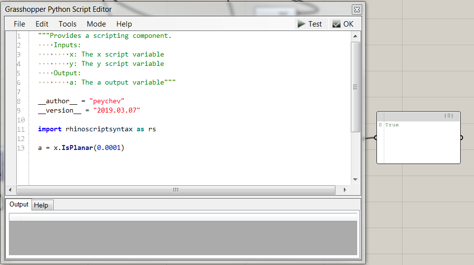

Ivelin,
I am getting an error when I run .IsPlanar on a srf. Can you see what I’m doing wrong?
tx,
dh
You have to convert the guid into an object. Perhaps you haven’t set the type in the input.
Right-click the “X” input go to the bottom of the context menu and select that the type should be surface.
oh, right, of course… Thanks!
