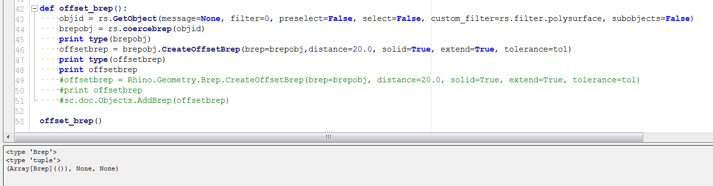

Though, I can’t make it work:
import scriptcontext as sc
import Rhino
tol=sc.doc.ModelAbsoluteTolerance
def offset_brep():
    objid = rs.GetObject(message=None, filter=0, preselect=False, select=False, custom_filter=rs.filter.polysurface, subobjects=False)
    brepobj = rs.coercebrep(objid)
    print type(brepobj)
    offsetbrep = brepobj.CreateOffsetBrep(brep=brepobj,distance=5.0, solid=False, extend=True, tolerance=tol)
    print type(offsetbrep)
    print offsetbrep
    #offsetbrep = Rhino.Geometry.Brep.CreateOffsetBrep(brep=brepobj, distance=20.0, solid=True, extend=True, tolerance=tol)
    #print offsetbrep
    if len(offsetbrep) == 1:
        sc.doc.Objects.AddBrep(offsetbrep)
    else:
        print "can't close the offset"
        return
offset_brep()
I did it:
def offset_brep():
    sc.doc.Objects.AddBrep(offsetbrep[0][0])
offset_brep()
