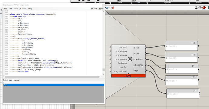

I am running a RunScript method in ironpython.
The codes seems to work correctly, but I cannot output anything.
What could be a reason for it?
 ![image](https://global.discourse-cdn.com/mcneel/uploads/default/original/4X/8/3/0/830bc2115debff4b8920057e3e989b1447851c5a.png)
<div class="post-metadata">
**Author:** ![AndersDeleuran](https://sea3.discourse-cdn.com/mcneel/user_avatar/discourse.mcneel.com/andersdeleuran/32/476683_2.png) [@AndersDeleuran](https://discourse.mcneel.com/u/AndersDeleuran)\
**Post date:** [March 23, 2023, 8:12pm UTC](https://discourse.mcneel.com/t/python-components-def-runscript-empty-outputs/156991/2 "2023-03-23T20:12:10Z")
</div>
It’s quite hard to tell what’s going on there. When you’re running a GHPython component in SDK mode you output by calling `return` at the end of the `RunScript` method. See Giulio’s old example here:
> [@Tutorial: creating a Grasshopper component with the Python GHPY compiler](https://discourse.mcneel.com/t/tutorial-creating-a-grasshopper-component-with-the-python-ghpy-compiler/38552):
> [2025 update: McNeel no longer suggests or supports this compilation method in new versions of Rhino] GhPython in Rhino WIP ships with an all-Rhino Python compiler that can be used to create .Net compiled assemblies containing compiled instructions. Unlike other methods that are based on embedding a Python code string in a C# component, this speeds up code execution and makes reverse engineering more difficult. There are two options for the process of making a component, #1 is extremely simplifi…
When you have several outputs you simply return as many variables (e.g. `return ham, spam, eggs`). On a side note I’d recommend running in procedural mode unless there’s a good reason not to.

Why don’t you do something like this?
```python
class Foo:
    def __init__ (self, a, b):
        self.a = a
        self.b = b
        self.c = self.bar(a, b)
    def bar(self, a, b):
        return a + b
if __name__ == " __main__":
    f = Foo(12, 14)
    # Outputs
    a = f.c

@AndersDeleuran and @diff-arch thank you both.
I finally used ` return ham, spam, eggs` option.
I went in this complicated way because I am using compas componentize workflow and am following the same template: [compas-dev/compas-actions.ghpython\_components: Trying to make Grasshopper development version-control friendlier since 1337. (github.com)](https://github.com/compas-dev/compas-actions.ghpython_components)
Seems to be a simple mistake. Thanks
