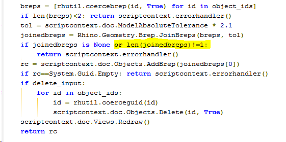

The thing about using rs.JoinSurfaces() is that it returns only one object ID. If you have a collection of surfaces that are not all joinable, it will return None. Whereas with Rhino.Geometry.Brep.JoinBreps(), it will return everything it can join, that may be a list of more than one object.
I don’t quite understand why rs.JoinSurfaces() was deliberately limited in that way, there’s no real need for that, as it’s just calling Rhino.Geometry.Brep.JoinBreps() in the background anyway.

To be fair it is in line with the documentation for JoinSurfaces(): “Joins two or more surface or polysurface objects together to form one polysurface object.” (emphasis by me).
Yep - in line with the documentation, corresponds with the VB version and probably because historically it was designed that way a long time ago…
However, things could be different, in order to not invalidate the original method, perhaps we just need a new one like rs.JoinBreps()
Agreed, a new function would be better, maybe TryJoinSurfaces that returns all successful joins, even if there are more than one.
As long as the user can appreciate that the results aren’t necessarily what one would expect, like with JoinSurfaces()- either you get the one joined surface, or you don’t.
