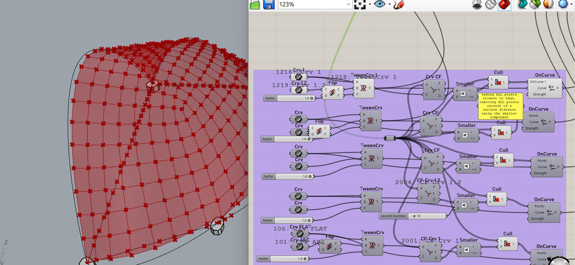

My question is, how do I snap/pull these mesh vertices to this tween curve (green) so that it serves as an anchor? I would replicate this for all of the perimeter arcs. I don’t understand why it isn’t snapping to the tween curve when I’ve used the on curve component. Been struggling with this for a few days now.

I realize it was a simple mistake. Just had to connect straight from the list of points, in my screenshot the split tree to the OnCurve component. Or in this edited version to the closest points to the OnCurve. I didn’t need the pull to curve component for it to work.
Only problem is, the points don’t exactly align to the tween curve and there’s weird jagged edges like here.
Kangaroo decides which point is “anchor” based on tolerance (not only anchor, any other point component). It does not have tree structure inside the component (only goals can be made with tree structure). So if you want the solver to understand “this point of mesh should be fixed” the point you are providing to anchor goal should be very very close to it (from dec mesh component for example).
I was able to remove the jagged edges by using the curve closest point component instead of the closet point that I used here.
Thank you for the reply @dfytz1 . With regards to these points on the mesh that aren’t on the corners, would you have any idea how to get them exactly on the corner?
Just use target input on anchor component.
