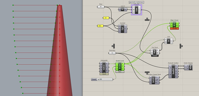

Guys is there a reason why pull points component moves my last point ? same with pull curve
See the image
Anyone had this problem?

And Pull point projects the point on the surface like this:
the way “Pull” works is moving the point to the closest SurfacePoint, and to do that it moves along the SurfacePoint Normal
so despite your “to be pulled” point having Z=703 and the top of your pulling surface being at Z=703, your point is dragged toward the surface in direction of the surface normal, which is not horizontal (as @ME_Mark well explained :smiley: )
for instance, if you had a cilinder with same axis and height of your shape, the point would be dragged horizontally:
you can get a perfect horizontal projection (not pulling) in several ways, one among the many (for sure not the best performing one) is by pulling (yes) your points to the axis-line that generates your geometry, and then intersect the connection lines with the geometry itself:
Point Pull_Re.gh (35.1 KB)
