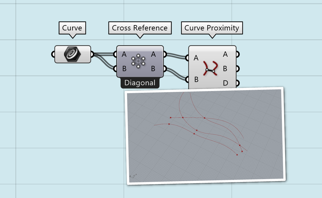

Proximity HELP please
Hey, go soft on the guy, he has just joined the forum :slight_smile:
Nevertheless Koll, he is right. It is considered nice to post your definition because it makes easier for people to help you. If you intend to visit the forum regularly, you might want to have a look at this post:
Now, about your question, what you are looking for is cross reference . But controling the distance? wouldn’t it be simpler to just create new curves?
