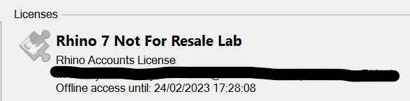

Also if you go to Options>Licenses in Rhino it will tell you if you are using the license in your account.
(yours will say “Evaluation”, not “Not for Resale Lab”)
If it doesn’t say Rhino Accounts, then you probably installed the license locally.
