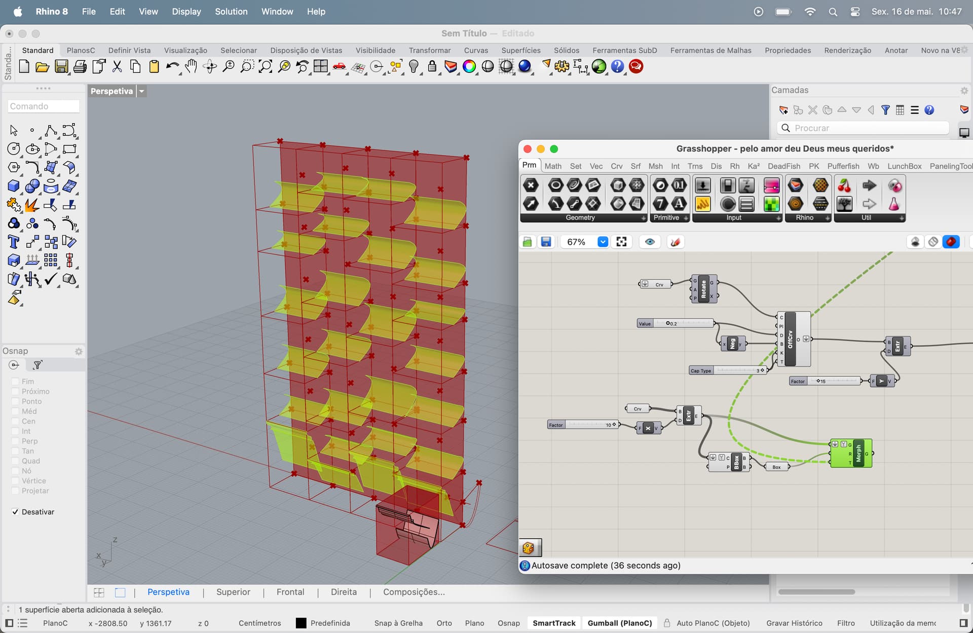

Hi everyone,
I’m using Box Morph to map a geometry onto a set of boxes, but only part of the geometry shows up after morphing. I used Union Box (with Flatten) to create a single bounding box that fully contains the geometry. Still, only a portion appears in the target boxes.
Any idea what might be going wrong?

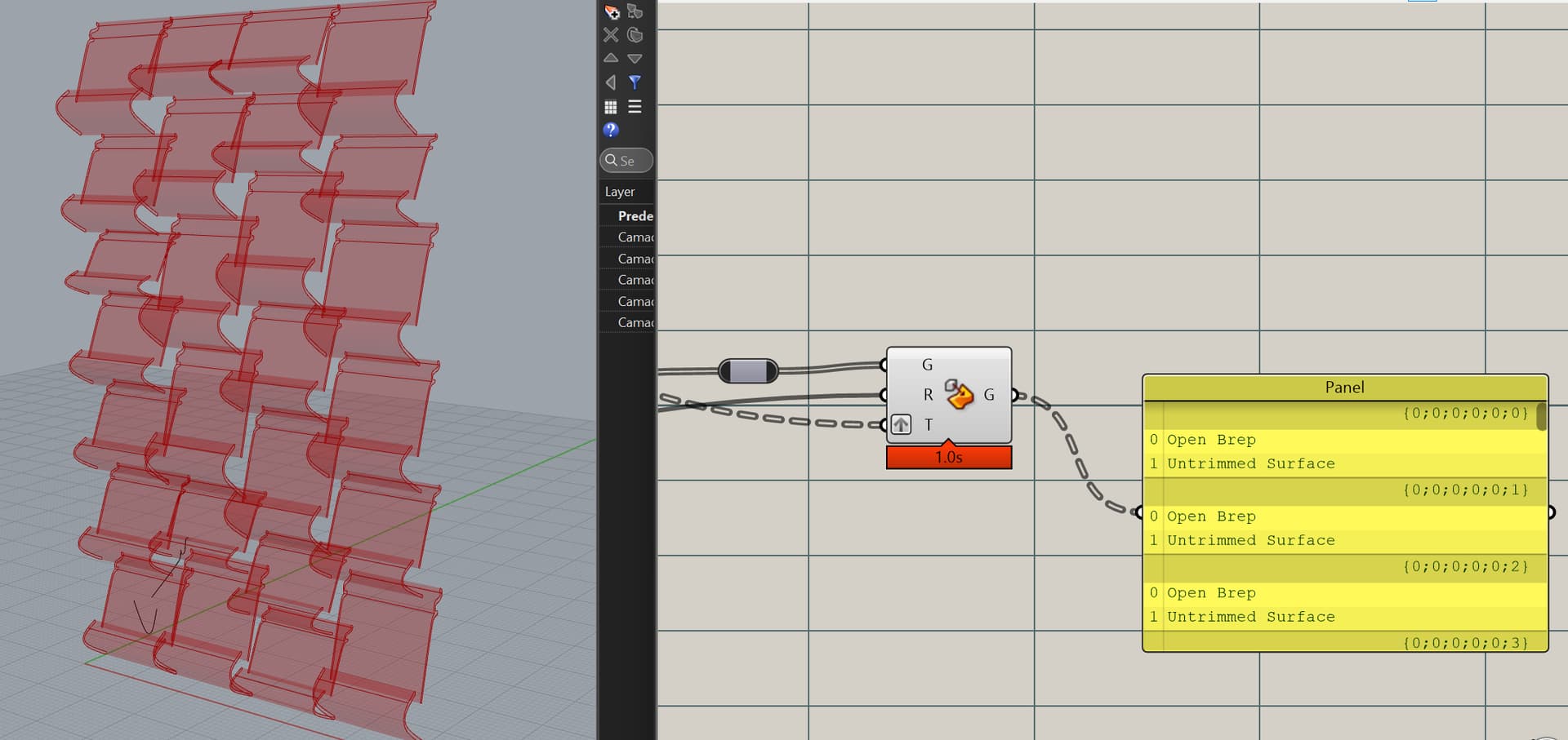

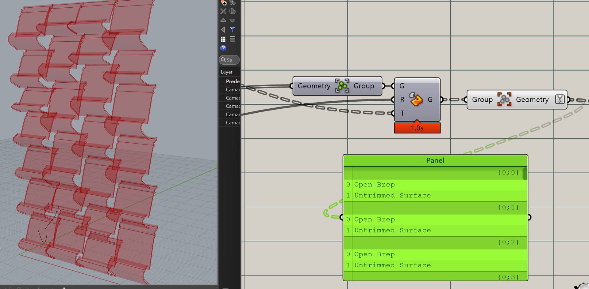

just group the input of the boxmorph
or GRAFT the BOXES
