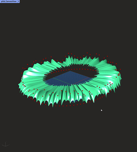

Hello everyone, I need the help of someone who can guide me because I don’t know what the problem is, I’m trying to make a cover for a stadium similar to Frei Otto’s in the Olympic stadium in Munich.
The idea is to have 4 Anchor points but anchor point number 3 doesn’t work for some reason. I don’t know if the Mesh is well done or the problem is Kangaroo.

A better version.
Thank you very much for helping me! Is there any way that the targets of the anchor point are the circles? so that the mesh is perforated and looks like this?
I tried this way but it doesn’t work, I think I’m doing something wrong, should I do it before converting to Mesh or after?

Hi @mauriciovb yes, circular openings are possible.
Yes, possible, but in your case, I think you need to overhaul the entire logic to get that effect.
Basically, you need to make holes first then assign the vertices of the holes to the circles.

That’s what I was thinking, I have to make the holes on a surface, convert it to Mesh and then assign the vertices of the holes to the circles, thank you for your guidance.

Hello, I was able to solve and make the holes in the mesh with the examples that you guys showed me. The anchor point 3 works perfectly, but now the anchor points 1,2 and 4 do not work when moving. I was looking for examples, but I am not finding them here, could you guys please guide me again? Thanks in advance.
I use gene pool to move the anchor points because after I will use Wallecei
