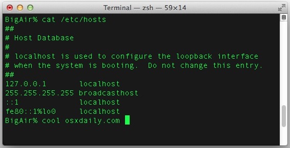

This is usually caused by macOS not recognizing localhost .
This describes how to reset your localhost list.
